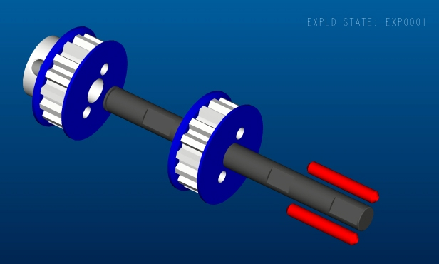

I've posted this before and had a chance to do some durability testing with an 8 single (stop go, brake, stop, go, brake). So far it has held up well. Make sure to use blue-loctite on the set screw or else it may loosen up on you....
This is Beale's idea and utilizes a secondary non-one-way pulley that has the boss machined/lathed off. It was then lined up and had two holes drilled. Finally it is held together with two rolled pins that were pressed in with a lot of pressure.
Exploded view of locked center pulley concept by Beale

Yeah, the center oneway is the easy part to lock up or mock up. Just the front diff was giving everyone the head ache. I'll try it later on down the line when I need it. Right now the oneway is all I need for outdoors.
