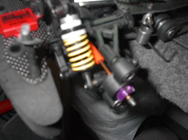

Since I have seen a lot of posts regarding lost dogbones, I thought that I would show what I did to find them quickly just in case I break my car (but we know thats not going to happen, right .) I just stretched some bright fuel tubing onto the dogbone shaft.

That's an excellent tip ! More rotational weight !
