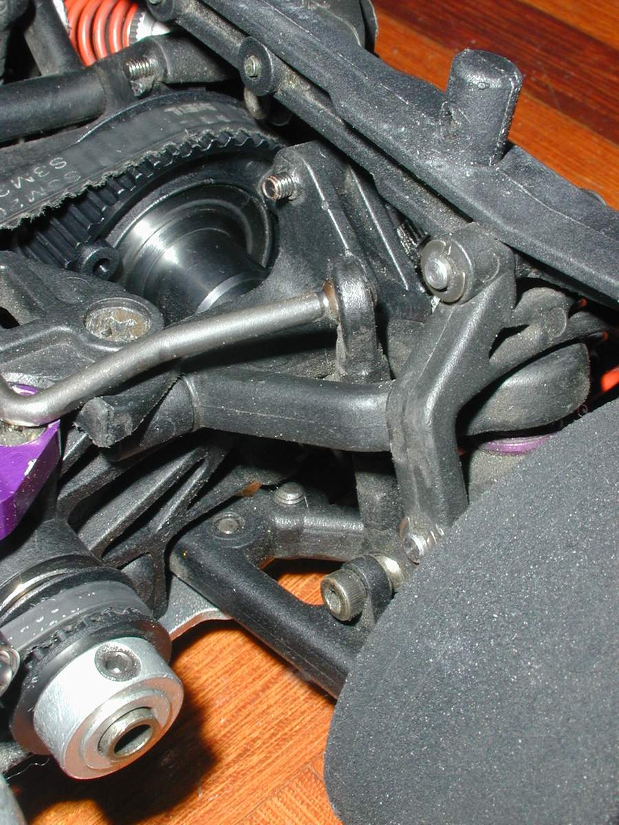

Well, I was actually not referring to running the FPS diff itself. I was referring to running the ordinary ball diff BUT using the FPS pulley instead of the normal pulley meant for the ball diff...

See the difference?

Yes i see. But it's you need more time to adjust the diff that with the FPS or Diffadjuster.

Not really. I find no difference in the time to adjust the modded ball diff than with the FPS. Put in the pin in the hole to lock the diff and turn the right rear wheel clockwise (to tighten) or anticlockwise (to loosen). That's it.

I further went ahead to use the FPS pulley on the normal ball diff because that one protects and closes the diff balls better. Also, not that it's a serious problem but it takes away the wobble found when you install the stock pulley. And yes, lastly the FPS diff pulley is wider and does not make the rear belt slip like what some people have complained...
