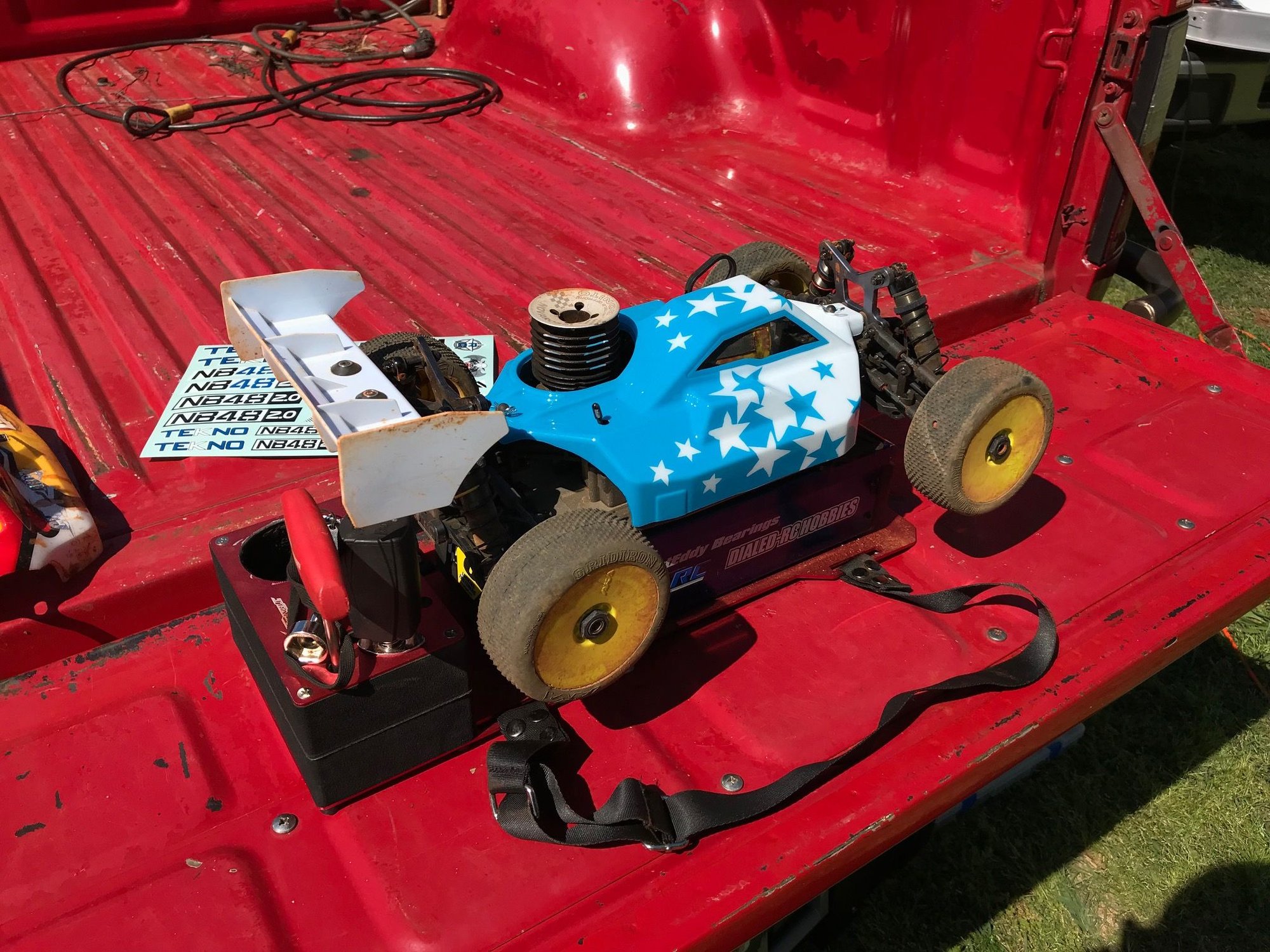

I've enjoyed my Bonito so far. I'm 1 gallon in on it, all on the same track (other than initial break in) running the Dynamite 053MR pipe/header in my Tekno NB48 2.0 with stock gearing. Just completed my first race yesterday and it did pretty good. I didn't notice a disadvantage of power compared to all the other nitro buggies out there, and mine is probably on the rich side of things.
Before race day, I decided to experiment with the 7.5mm venturi that's included with the engine. I needed to know what my run time was to get a pit strategy lined up before race day. It went 8:45 without the venturi in. Then I put it in and repeated the test, and surprisingly it went less time, at 8:15. Not sure what the deal is but I didn't change the tune whatsoever during the experiment, and I was driving at a safe pace to ensure I didn't flip over since I was the only person at the track. This is the first time I've ever had a venturi, and I haven't looked into them much, so perhaps that's normal?

your fuel mixture was set for no ventur,i and then you put a venturi in which richens it up since you are asking for less air but never leaned the fuel. You had all the power you needed with no venturi, and pulled the trigger less. But when you put a venturi in, the smaller the venturi the less power output. So you were pulling the trigger more to try and get the power but you were running it a tick richer. Makes sense?

Yeah I figured there had to be some corresponding tuning warranted to follow the venturi installation.
It's interesting to have the info in mind going into the tuning session -- knowing that without any tuning at all, adding the 7.5mm venturi hurts the run time by roughly 30 seconds, so as I get the tune closer to ideal, it's mileage will first only recover back closer to how it was to begin with, then beyond that point, the mileage will get better than before. No doubt that's a rough figure, since the temps/humidity/traction/etc will all be different whenever I do this compared to the day that I timed my runs a week ago.
