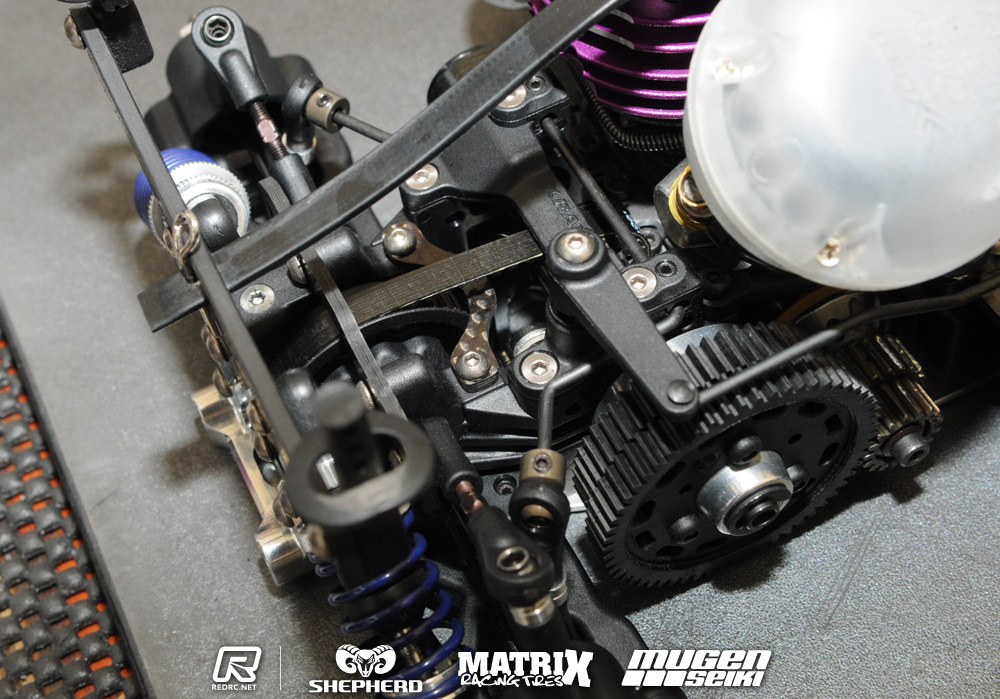

Does anyone knows the sense of the brace in front of the rear diff?
You can see it on one xray in the EC-A Gallery from last weekende at redrc.
I cant upload pics. right now :/
Thanks!
Thanks!
this one?
So the 2 spd shaft bearings dont bind under lateral load, and maybe to take away some of the rear flex for more steering/ unstick the rear end. I chopped up an old V1 topdeck to do something similar a couple months ago.
