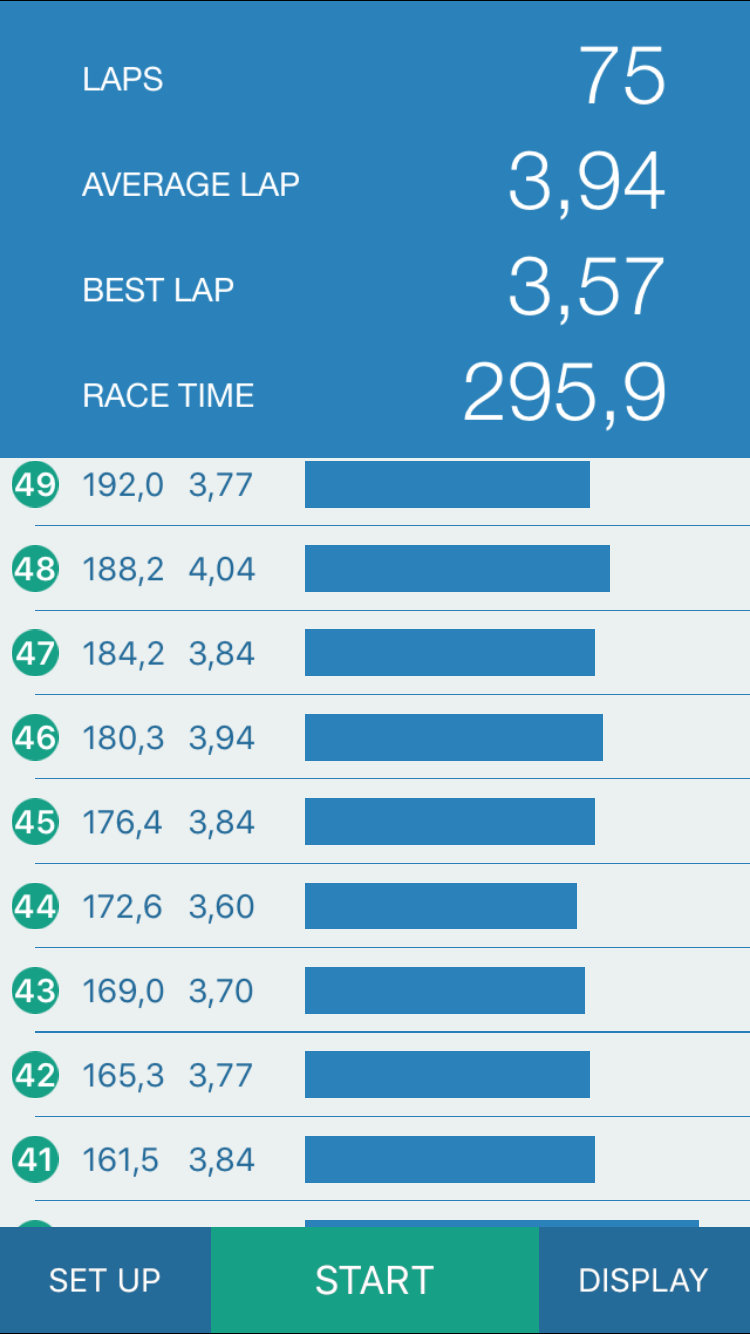

Classe- Classe ProStock
Data-05/06/2020 Luogo-
Brindisi, Italia
Tempo di gara- 295,9
Giro più veloce- Telaio 3.57- Corpo
MR03
EVO- Audi r8 GLR
Interasse- Pneumatici
98mm- Marka v6F20 anteriore, Marka v1R 05 posteriore-
motore- kyosho5600 kv
Batterie- Kyosho speedhouse
Fronte Springs- Kyosho primavera rosso
in fibra di vetro T-Plate-Kyosho 2S
antivibrazioni (se applicabile) -
Dampener fluido (se applicabile) - N / A
Gearing-44/6
note

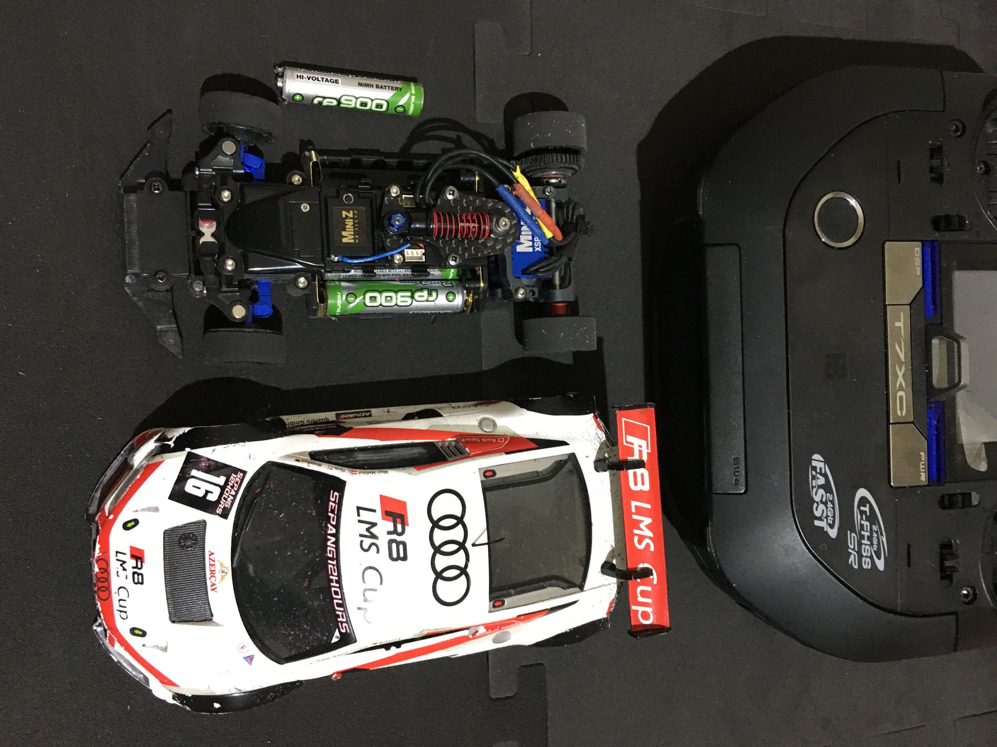

Scott, here is my newest build. It’s going to be a brushless sister to my F-430GT PN70T car I run in stock M96WC. Keeping the stock MM2 pod and DDS for now but swapped the 5600 for a 4100 motor.
