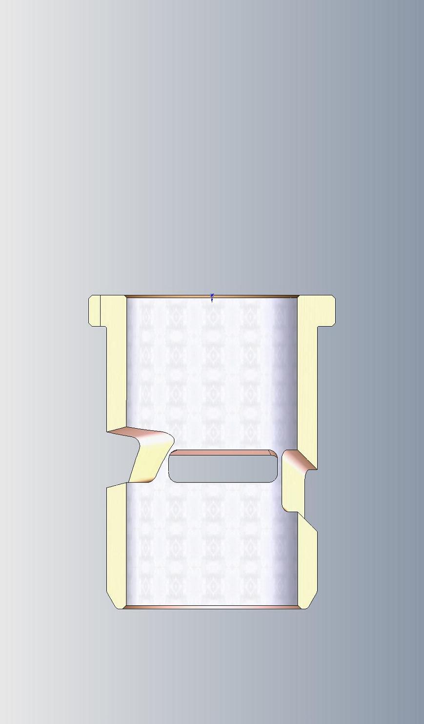

Hi Ed. I have 2 of the 4 liners you sent and they are all the same. I tried machining 0.3mm off of the bottom of the liner flange and still the same. Any ideas?

Hi Ziggy.
Can you please describe more, I didn't get what you try to descibe. Can you please give small hand drawings-it will be way easier for me to understand and give to you idea Please download attached pic and make sizing on it and put it back so I can see it.
Edward
