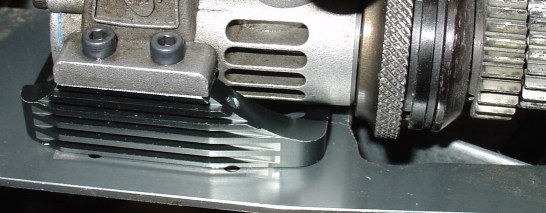

Originally Posted by Artificial-I
1. The exhaust port sits very close to the side belt.
On my Yokomo GT4W2L the exhaust port its ALMOST rubbing against the belt, but it was just a thing of moving on angle the header to clear the problem ... and its working great for the last 2 years heheheheh ...
2. When installing the motor and tightening the engine down. I noticed one bolt was having trouble staying still. It might have been the screw.
Always be sure to use good screws on your engine ...
3. Then I finally noticed the flywheel is exposed underneath by like 1-2mm. I have installed two other motors on the car and none had this problem.
This its easy, just shim your engine mounts in order to clear that space ...
hope this helps ...
He have installed two other motors on the car and none had this problem.
Anyone got any ideas?
HPI PRO 4 has some 2mm or even 3mm spacer, you can mount those right below the enigne (above the engine mount)..........it has the bling bling purple color that match you R40.........however, I don't understand why their engine will seat lower then the typical engine spec....you sure you used the right engine mount (I doubt there are other R40 engine mount) or Flywheel (again, same thing...)
Just had my omega mounted on it and it fit perfect.

Old 06-30-2005 | 10:40 PM
  #1738
Artificial-I's Avatar
iTrader: (17)
Joined: Jan 2005
Posts: 3,459
From: Rurouni Kenshin
Well I shimmed the motor up. Took maybe 1mm to fix the problem. The flywheel was barely poking out but I just didnt want to cause trouble and this also helped me clear my belt a bit more... So I went ahead and loosened it.
