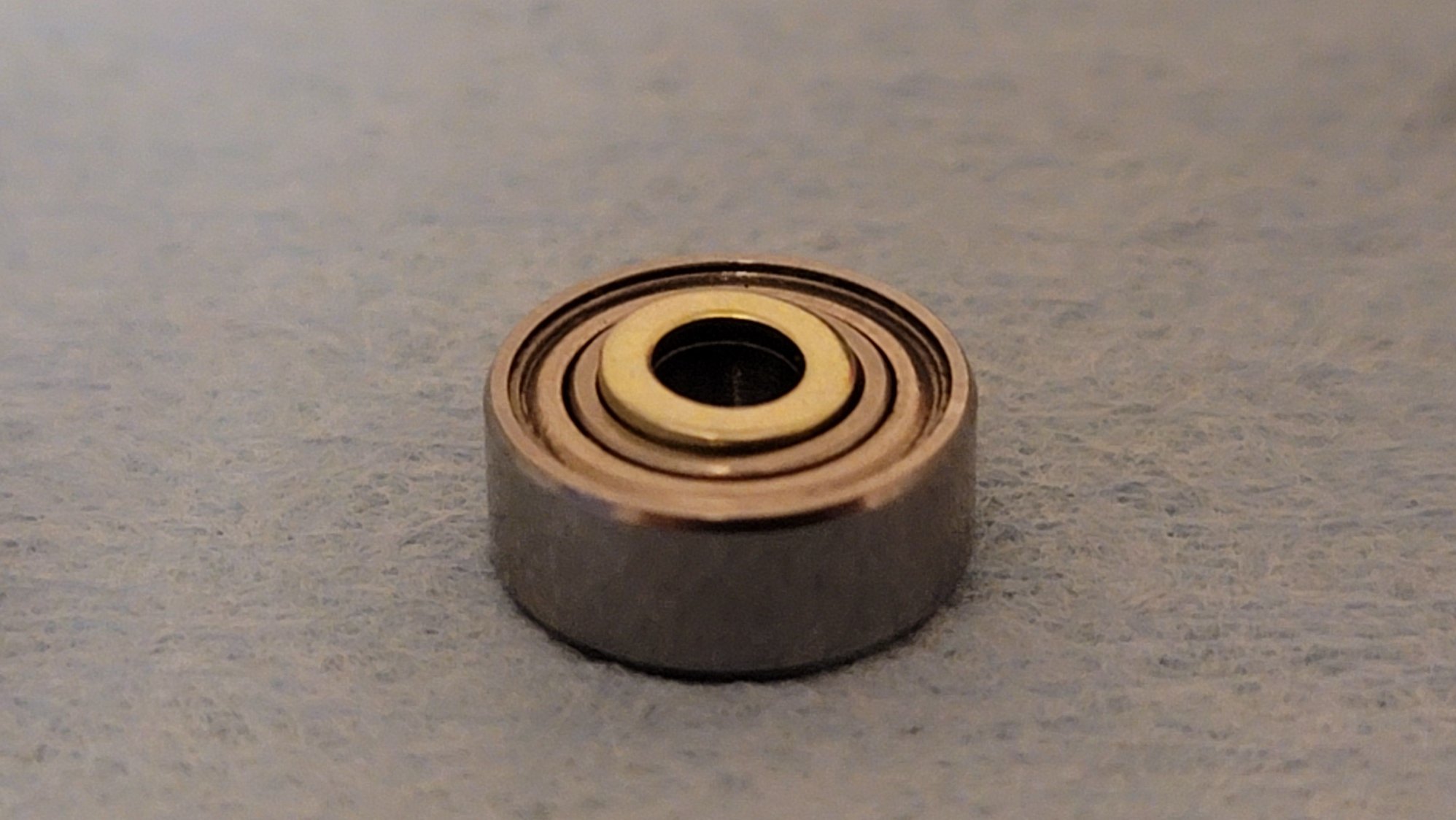

I have new hardware kit, but when I screw it in it presses outside bearing and can't spin.
Get a pack of these and shim the end of the crankshaft until the clutch bell screw doesn't pinch the bearings anymore:

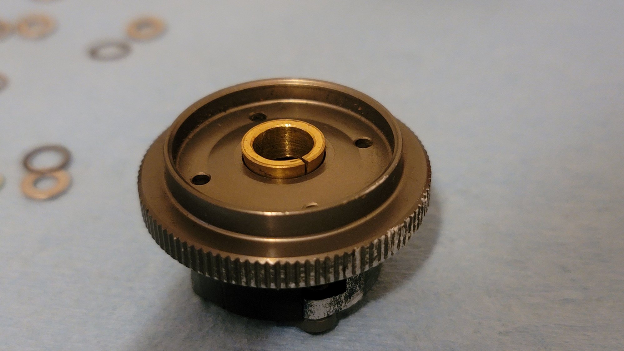

Lot off replys to quote so here is what I have for you.
Should I get a sand paper and sand it down where cut in the collet is, so I get these 2~mills
I have Losis washer set, these small ones are 5mm and can't quite fit inside bearing, crankshaft is showing 4.9mm
If these would squeeze in it could work

Then take your dremel and take some material off the outside of that washer until it fits inside the bearing without rubbing. That washer looks pretty thick to work correctly considering you're probably only off by .1mm or so.
exactly what I did
And looks like I need one more, trust me there is a whole millimeter of short crankshaft.
tell me should collet go completely into the flywheel or no?

Ok I made it work, tnx everyone for helping new guy 🙃
that one shim was enough, rest was filled with little plastic part that goes before screw and perfect amount left so bell can play a bit.

If you use that washer on right on other side it sticks out and goes into the gap between bearing and crankshaft
Start with grinding the cone a bit smaller, it is sticking out too much.
