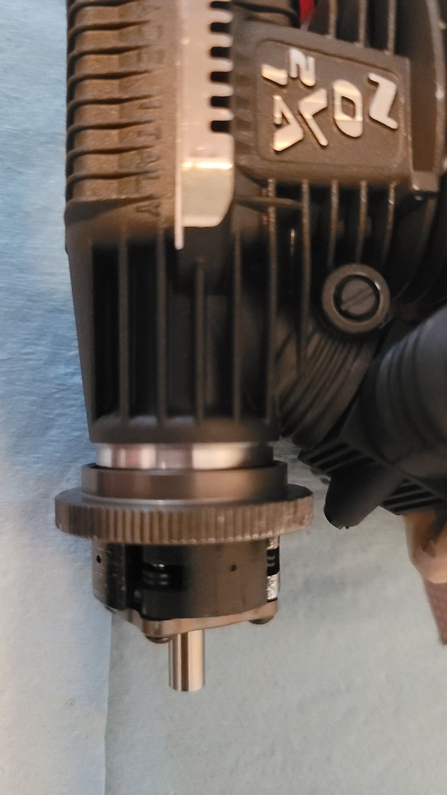

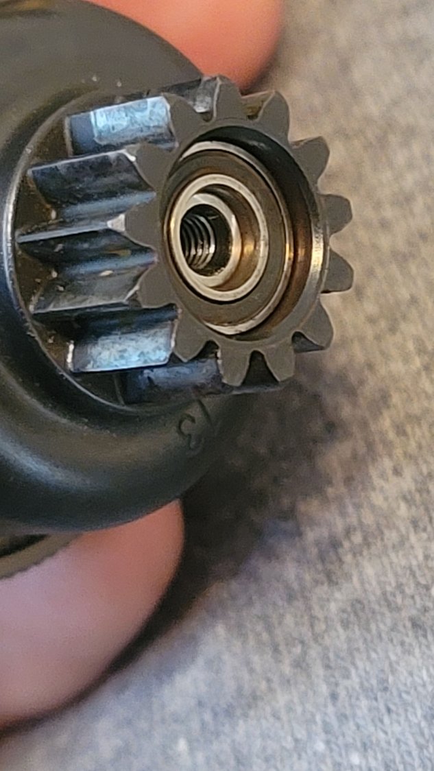

Me again needing help🥲
finally started putting this thing together and I encountered a problem. When I tighten cluch bell it gets stuck, doesnt spin freely. Reason behind it is position of my flywhell. I will post coulpe of pics, basically my crankshaft is too short using this combination of motor, collet, flywheel and cluch bell
I have 2 collets actually but they position flywhell at the same place, and you can see it's not in the center.
Help me out good people.
bratan is offline

Is that a Losi clutch bell? Also what clutch is this? Kinda looks like a Protek or Serpent.
you need something like this
finally started putting this thing together and I encountered a problem. When I tighten cluch bell it gets stuck, doesnt spin freely. Reason behind it is position of my flywhell. I will post coulpe of pics, basically my crankshaft is too short using this combination of motor, collet, flywheel and cluch bell. I have 2 collets actually but they position flywhell at the same place, and you can see it's not in the center.
Do you have the washer behind the collet? You need the short collet with the losi clutch.
