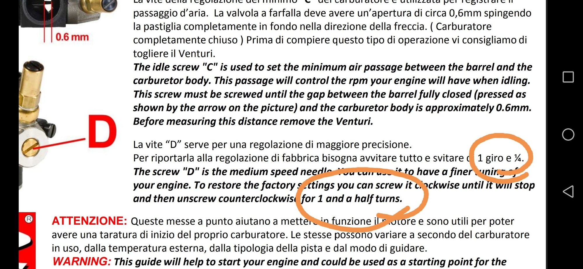

alex_blais 04-23-2020 09:00 AM
So is it 1.5 or 1.25 turns on the D screw?
https://cimg7.ibsrv.net/gimg/www.rct...554be70b80.jpg

i have found the needle seat adjustment to work best at 2.25 turns from all the way in .... this allowed much more usable adjustment of the low speed needle ....... mush less finicky and stayed more consistent .....
hope this helps
