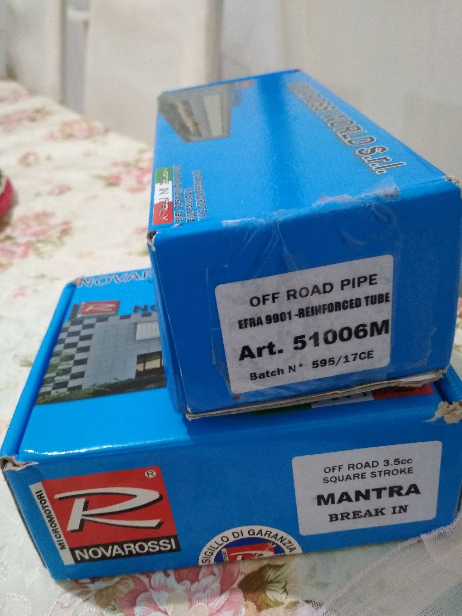

need advice choosing nova engine here
keep off
virtus off
mito 40
mito 70
mantra
best performance based on u guys ever experience,,

Joined: Aug 2012
Posts: 399
soo excited
perhaps will be my best friend for next race season. question here, which venturi should be use? and how many tanks for factory break engine before go to race tuning? what method theyre using on factory breakin, is it EBIS?
thx guys
