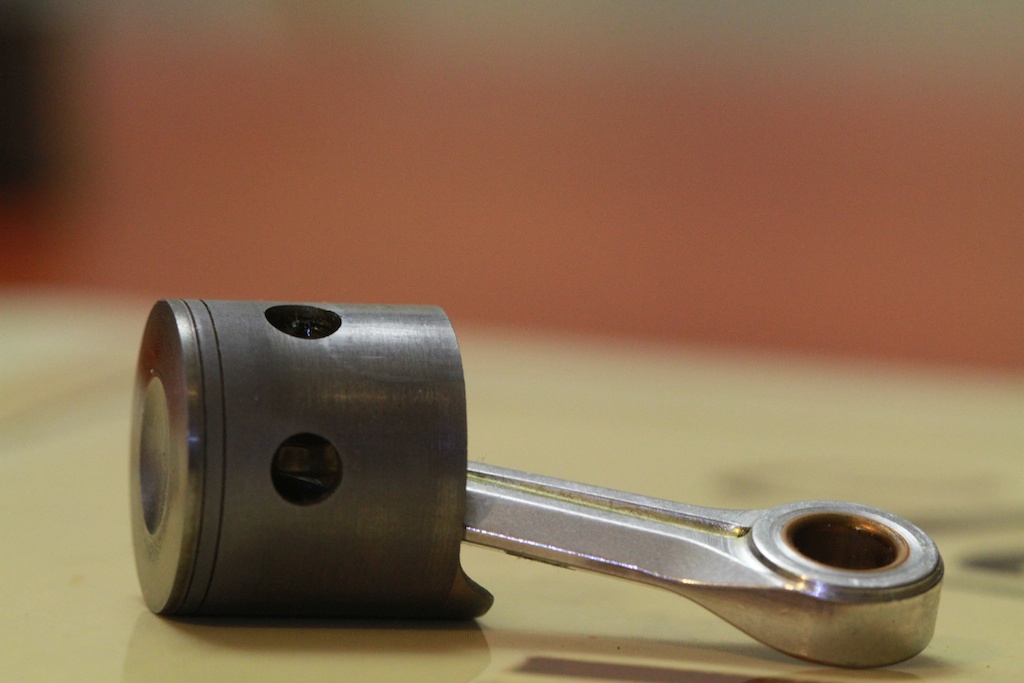

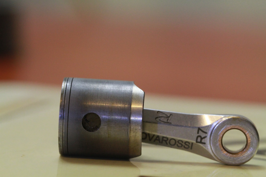

pics of the Piston.

One more thought on the flame out.. I'm running the Buku Clutch with Ceramic pads. I just inspected the Clutch Bell and there is already a good grove in it. This is after about 1/2 Gallon. The Springs are set at stock meaning they are set very soft. Could the Flame out be caused by early engagement of the clutch on load? The Track was mostly clay. I would consider VERY high traction and I was using New Super Soft Gridirons that were hooking up like mad. Sorry for the rookie type questions but I don't want to leave any rock unturned on this one..
a low stalled clutch will force you to set the tune very very rich on the low end...which will indeed make the engine more prone to flameouts.....if you try to set the LSN to a safe mixture the engine will develop a lean bog....ultra LOw stall makes the LSN far more difficult to tune
