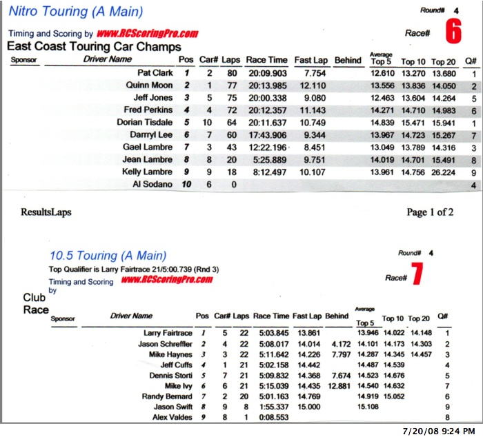

ToysRUsKid 07-22-2008 12:51 AM
Success with NT1
Took 5th place in the A-Main at my first trophy race with the NT1 this past weekend. Check out the standings...
http://www.rctech.net/forum/attachme...8&d=1216603643
http://www.rctech.net/forum/showthre...=228780&page=6
Still learning a lot and the guys there all helped out, but hey, 5th is better than nothing. Not to mention I was bumped in by taking 1st in the B-Main.
