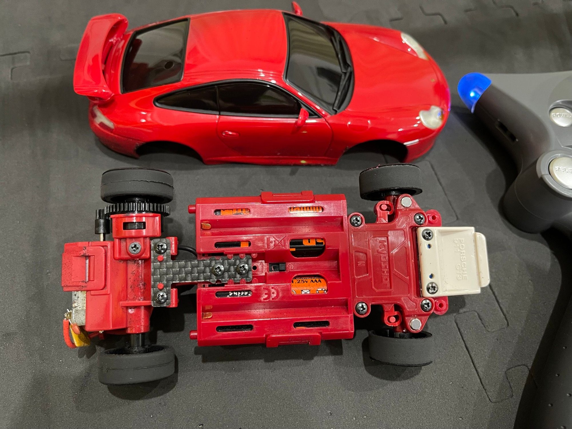

Class- Porsche Cup
Date- 10/2/23
Location- Singapore
Race Time- 353.760
Fastest Lap- 3.932
Chassis- MR-03 ASF
Body- 911 GT3
Wheelbase- 90mm
Tires- Front Marka V12, Rear Marka V1
Motor- Stock
Batteries- PN750
Front Springs- Kyosho red soft
T-Plate- Kyosho CF medium
Motor Mount- Stock plastic rear-mount
Dampener (If applicable)- Centre oil shock
Dampener Fluid (If applicable)- #200 shock oil
Gearing- 7T
Notes- Few laps affected by traction rolling and slow reverse.

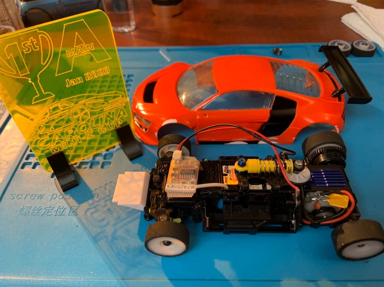

As the person that compiles the results every month, it’s a lot easier to do it from RCTech, where all posts are in chronological order. It’s also easier for racers to see their progress and changes in setup over time in the forum by using the thread search feature to filter their results for a certain class. These things are not easy to do on Facebook, but it is better for random posts and discussion of specific topics, so they each have their benefits.RCTech’s mobile version was down for a while recently, so I accepted race results on Facebook, but now that it’s back up, the official race results will need to be posted here to count in accordance with the rules. Interim race times and other discussion can continue on either site. We have a lot of new racers starting in the M96WC, so I’m looking forward to lots of new entries this month.

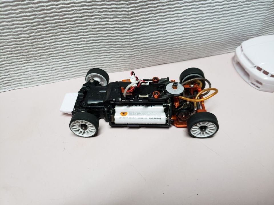

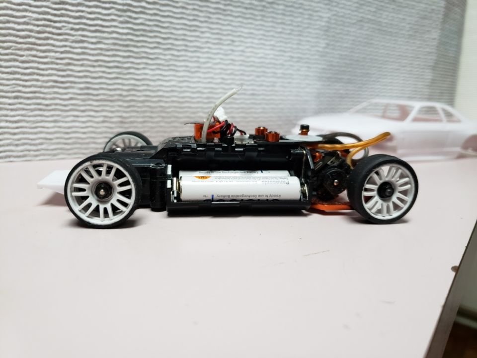

Thanks Traveler2! I noticed that you had run your wires that way, and I'm trying it now. It looks like it will work well, as I thought the wires might hit the body and cause issues, but it seems good with both the Skyline and my new Ferrari 575m I got from PoorBoy. Pics to follow.
