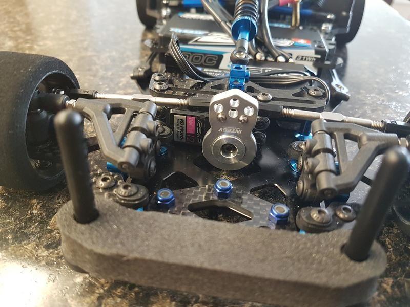

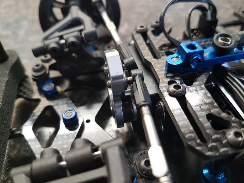

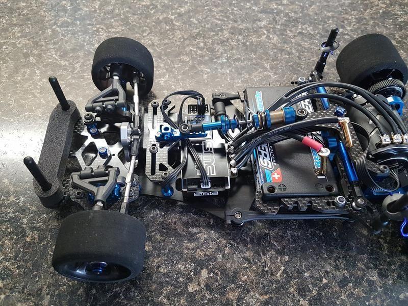

Here is the fix so far. A few extra grams for this Integy Aluminum Servo Saver I had. It's diameter is smaller in the spring and rear spline piece to fit and not have to shim up the servo plate on their posts.
