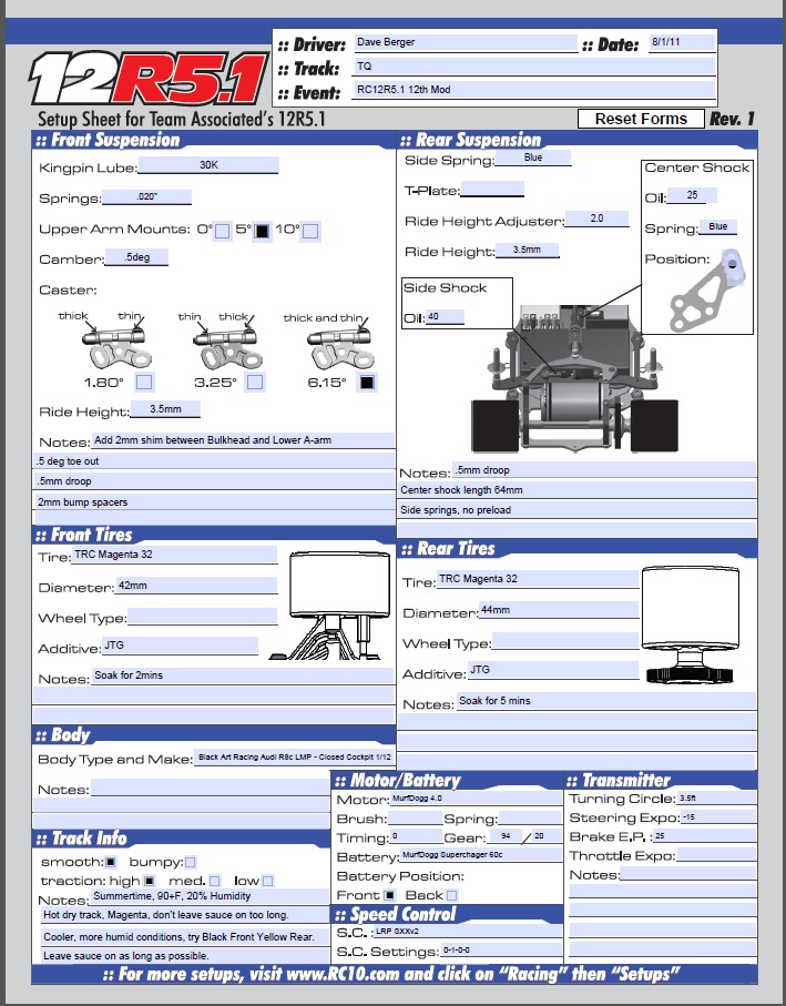

How about a base set-up for mod at TQ?
Working on getting the 10.5 to run with the SPX.

Here you go sir.
Attached Thumbnails 1/12 forum-tq-mod.jpg

Thanks.
How do you check droop with a pan car?
