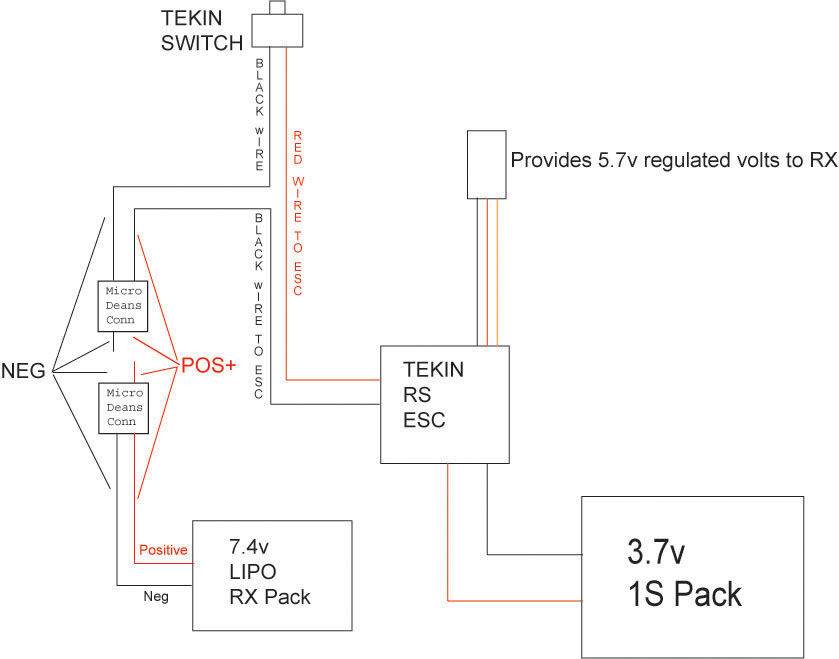

As of now, ROAR is staying 1S (3.7V nominal; 4.2V fully charged) for 1/12. There are many 1S ESC's with a built in BEC so nothing else is required to power the receiver and servo.
If you don't want to lock yourself into a 1S specific ESC, you do have other options! It is possible to use your 2S ESC without a booster or receiver pack, and the ESC simply supplies the lower voltage. If that does not appeal to you, you will need to use an Rx pack or booster. The Rx pack and booster will both supply the receiver with a higher voltage than the 1S pack.
If you decide to use an Rx pack, MAKE SURE TO REMOVE THE RED WIRE FROM THE ESC PLUG THAT GOES INTO THE RECEIVER!!!
If you choose to use a voltage booster, it works exactly how it sounds. Instead of plugging the ESC into the receiver, it plugs into the booster, and the booster plug goes to the ESC, supplying the higher voltage.

Hello 12th scale gurus...
I'm getting back into 12th scale and I vaguely recall seeing that some guys were running KO radios (receiver/servos) off of 7.4V. Could someone confirm whether this is an option? I have a Tekin RS that I'd like to repurpose rather than buy a new ESC that has a built-in booster but the local hobbyshop only has small Lipo packs to use as a receiver pack and I was hoping to be up and running this weekend.
Any advice you could provide would be greatly appreciated!

OK...now you've confused me ! When I ran 12th scale before with my Tekin I ran a 200mah LiFe pack that plugged directly into the battery plug on the receiver. All I have available to me right now are small 240mah 2s lipos and I was thinking perhaps I could simply plug that into my KO receiver without overloading the receiver and servo with 7.4V?

You will probably be fine going straight but if you want to be sure, you can wire the pack into the switch. It works great.
I was going to post the diagram for you but I had a crash the other day and now all my pics are missing
I gotcha both covered
1/12 forum-tekin-1s-2s-lipo-rx-pack-inline-switch.jpg

Thanks for the input guys!
I had since found the diagram but thank you for posting it here...I'm a "visual learner" kinda guy and couldn't wrap my head around the description of it but it makes total sense to me now that I've seen the diagram. I think I'll probably wire up a tiny Lipo that way.

you are correct that the ko servo and receiver can tolerate the 2s lipo voltage but NOT the tekin rs.
you need to add a booster to the 1s battery, or use the 2s life battery, or do the BEC wiring trick on the picture above.

I've actually been running the same RSPro for three years with a 7.4 lipo plugged directly into my rx. MAy not be recommended but I haven't had problem one, and I race twice a week.

Take care!! That works for a Tekin because it can handle up to 3S input voltage. It will not work with any speedo that is designed for a maximum of 2S input voltage - you will release the built-in smoke!!!
It will not work at all for a Hobbywing, and I think it will make an LRP turn from blue to black! HTH
