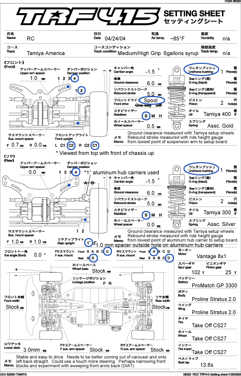

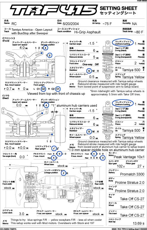

DS, this is Rod...here are the links to a couple of the Tamiya America setups. One for spool and the other for one-way.
As for changes on the spool setup, I think I ended up using a C/A or D/A front suspension block setup to get more mid-exit steering. I also used yellow sway bars all the way around.
I hope this helps.
415 One-Way Setup
415 Spool Setup

Originally posted by TJ
rtypec:
Is these setups with the LW convertion kit on it?
stock suspension.
rtypec:
Nope, I've got a set but have not put it on yet
