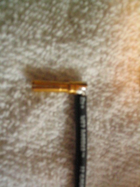

Attachment 758686
Attachment 758687
Attachment 758688
I used ProTek bullets which are a machined bullet instead of a stamped spring-type. They come notched for inline or 90-degree install. I heat shrink all my connections except these because of the bend. There is no chance of contact, though. Hope this helps.

Attachment 758686
Attachment 758687
Attachment 758688
