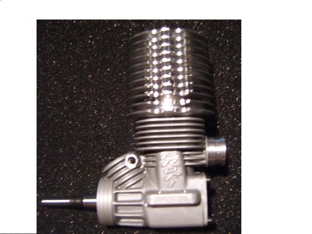

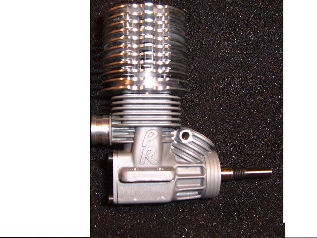

Default Palmaris Profi PR
Here is some close pictures of our new motor This the best I could do with my camera

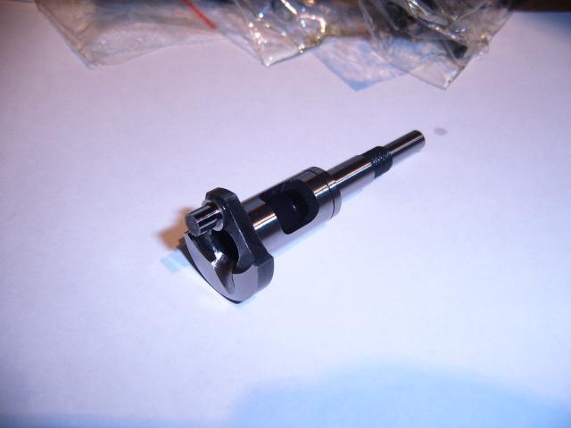

Default Cranckshaft for Novas
Here is pic of our new product-cranckshaft which will fit in any 14mm strock Novarossi based engines.
There is 2 version available-stock (no turbo scoop, but timing is altered to best performance and no filling), Fully modded-Turbo scoop, chamfer, filled.
All version has altered induction timing and all of them driled to be lighter.
They made out of high alloy steel, which has great advantage-it is heat treated to 45 Shore base metal and surface treated to 63 shore. This steel has ability to do not get soft (burn) up to 450C. We use this still for crancks for about 20 years for now and never have any trouble with that.

Hi Christian.
Main difference is that PROFI is monoblock type with sleeve, which is basecaly is conventional design.
Yes it is much more powerfull even from the box and not even head shimming tunning-we just run on wam up and went in to qualifier. By the lap time it was keep up easy with JP FX 12 full mod version and PROFI is not full mod version-just the stock, not even Bi-metall.

I'm here at the TX Biggie, just got back after practice all day. I ran a Rex RER with a BRB and his new crankshaft. The engine performed really well! I was surprised to find that I had to increase the 1st gear and 2nd gear to suit the power of the motor. Late in practice I decided to try Edward's Rex with his Bi-metal sleeve that he was kind enough to send to me for this race. OH MY GOD!!! This thing is unbelievable!! It's the fastest engine I've ever ran. It has crazy bottom end! It shot me past every corner until I got used to it. I'm running the tallest 1st and 2nd gear my RRR has and it's still asking for more. I can't wait to run it more tomorrow. I'm sorry Edward, but I accidentally spilled some JBweld on the motor mounts so I'm afraid it'll have to stay in my car

Default 21 crank
Hi Ed,
are you going to develop the 21 crank for nova base motor. Don't know why most of the nova crank does not fit perfectly to the rod even through the motor is new when i checked with digital clipper. hoever, the JP crank and RB crank fits much better with the rod and more precise which I observe
