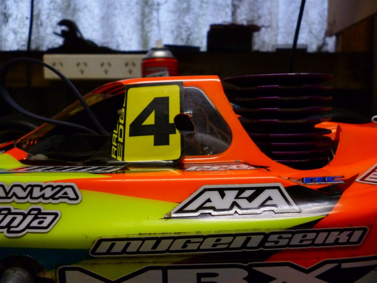

Ok here are some pics of how it looks with body on. I have cut out a fair bit round the engine head. Cant do much with the hole in the front window as it is. The top of the head as you can see sits just about level with the roof of the body so there is not much air flow through the top.
