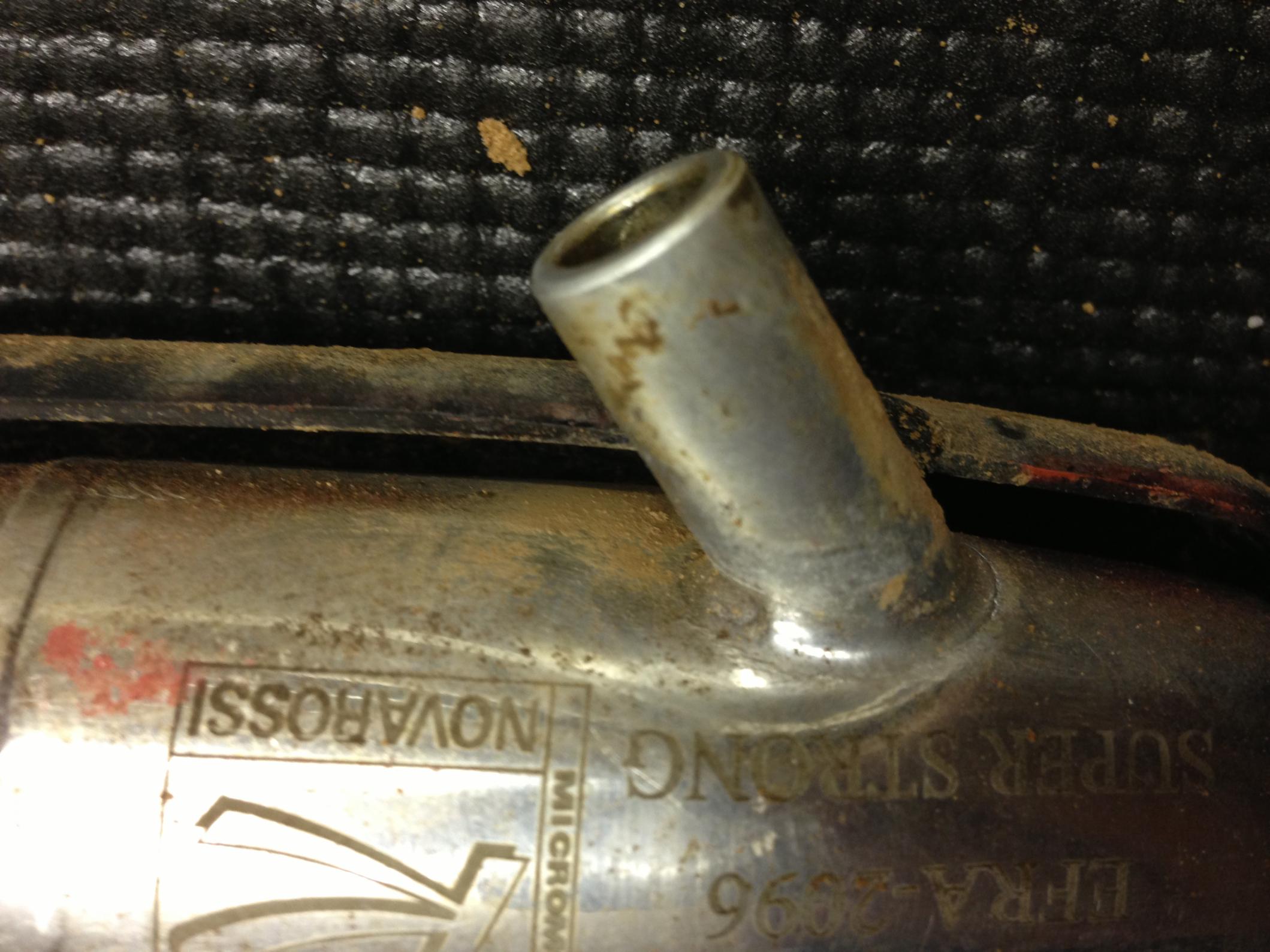

Originally Posted by T.Ngo
Will this dent hurt the performance of the pipe?
Attachment 1009456
Attachment 1009457
Attachment 1009458
It definently won't help...
I would straighten it out. Find something that fits SNUG inside of stinger, phillips screw driver? heat it up, insert snug fitting tool, slowly bend back.

Ok ill try that thanks
