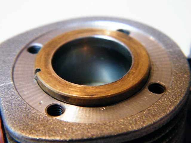

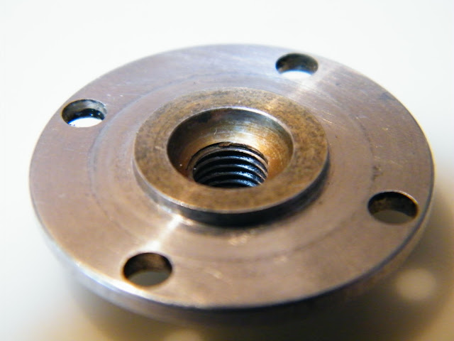

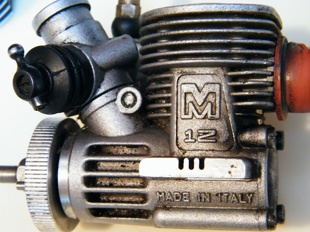

I have an old Novarossi M12, and am trying to find out more information. Specifically if I have a turbo or non-turbo button and what model M12 I have. MR I think?
I dug through the Novarossi site and looked through the 'Discontinued Models', but couldn't figure it out from that, either. Is there a pdf there for this?
I have more questions about it, but I'll start with this.
This engine is for my (also old) RC10GT FT.
Pics...really big pics. I can take more if you need me to.
I would greatly appreciate any info you could give me!
https://lh3.googleusercontent.com/-2...0/DSCF6018.JPG https://lh6.googleusercontent.com/-T...0/DSCF6022.JPG
https://lh6.googleusercontent.com/-B...0/DSCF6020.JPG
Thanks,
~Jeff
Som3R3tard 10-24-2012 12:32 PM
Looks like a non turbo button. I don't see the taper a turbo head would have. And being that old Im not sure if turbo plugs even existed then.

JSchubz 10-25-2012 09:39 AM
Old School.....
Anyone else have any more information on the M12?
I am having a hard time finding much for it.
I'm guessing that it is from the mid-90's?
R/C Lidz 10-25-2012 09:55 AM
what else do you want to know?
if you expand your search for MT12 you'll have more hits.
I have one in my FTGT and I think it's one of the best nitro motors ever made. Perfect for nitro trucks. Just keeps going and going
