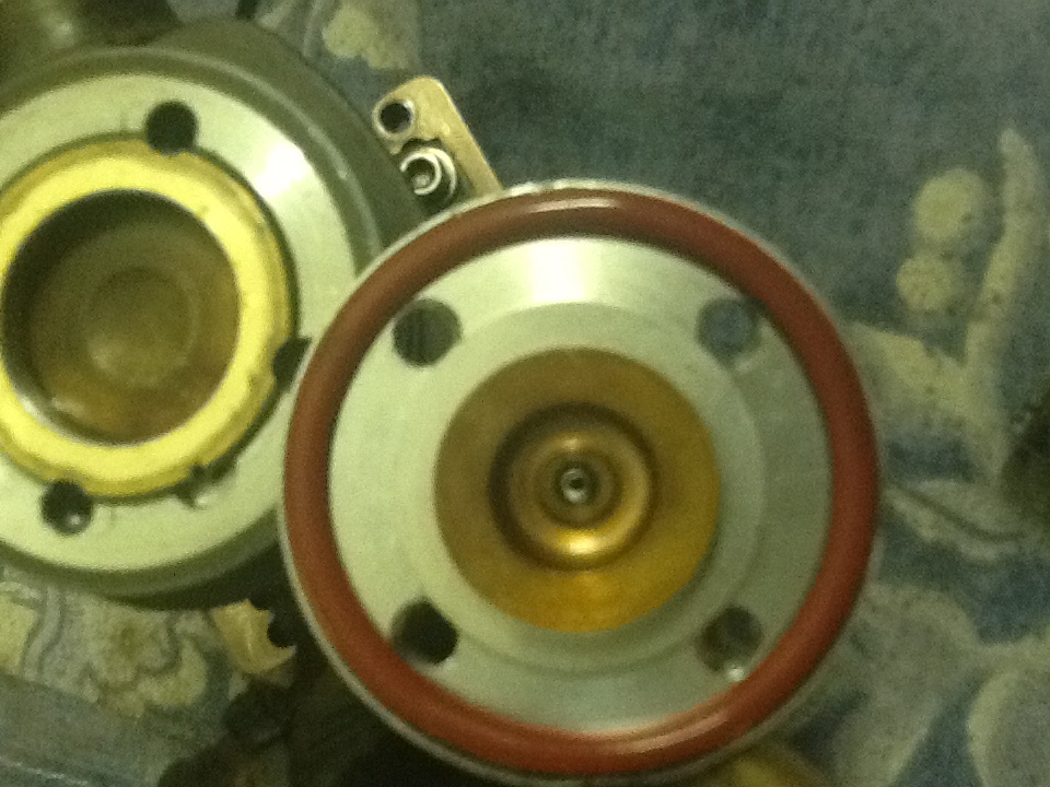

Hey guys and girls, can I get a comment on these pics. It's my Roma and would like comments on condition. I'm using nitro x 30% and had a c7 plag in as temps were around 32dec cel.
