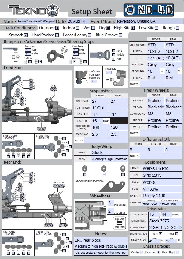

Best I can do is a jpeg. Tried to zip it but it's still a tiny bit too large.

lol looks familiar!

It should, see post 2141 I didnt have to make many changes at all, it just worked great at Revelation. I havent run it at another track yet but I think you've nailed the baseline setup for outdoor tracks.

Mo put a lot of work into this setup and it's killer everywhere. You won't be disappointed....
