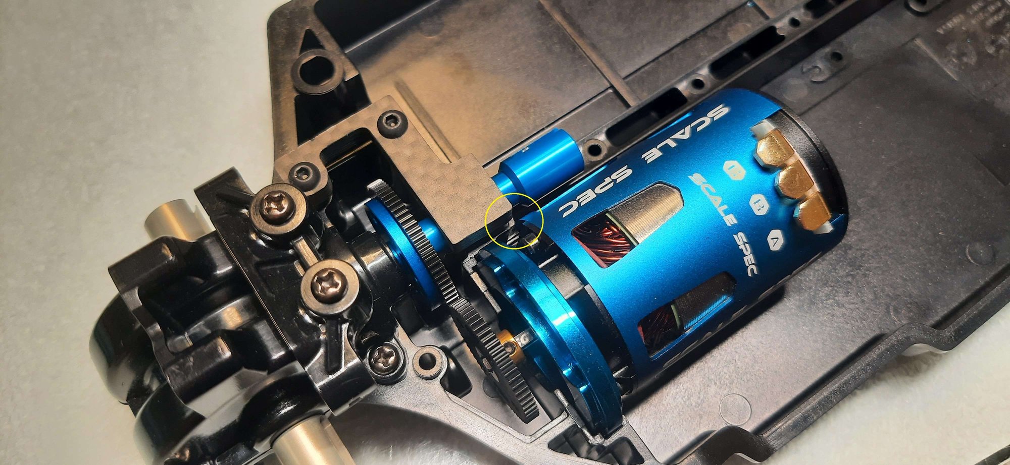

Finally got my GT12R dialed in and got to mess with my TT-02 tonight. I'm trying to figure out what kind of gearing works for a just for fun VTA build. This is an Arrowmax 59 pinion and a RW 68 spur (3.00 FDR). I can go slightly smaller on the pinion with the 68 too. I tried 54 and it was touching but pretty loose. The only thing stopping the motor from meshing better was this corner touching the motor where the bearing is on the chassis. A little grinding and I could fit the 54 to get a 3.27 FDR without having to change the spur. Also you can see there is quite a bit more room for a bigger pinion and/or spur to get a much lower FDR!
https://cimg6.ibsrv.net/gimg/www.rct...a00a3ea7c2.jpg
