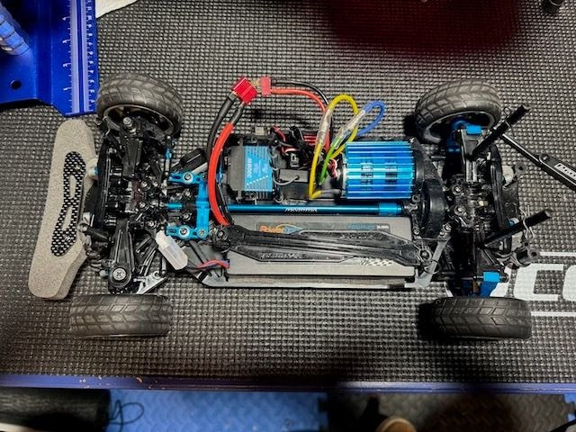

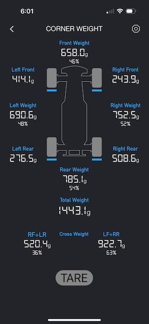

If we go with a shorty pack in a TT-02........what does everyone use to keep the battery in place front to back given the extra space created by the smaller pack? Is it TCS legal?
Figured I might as well throw up a pic of where my little guy is at.......because pics make people smile.

Current porky weight with body and wing.
https://cimg5.ibsrv.net/gimg/www.rct...e66ef7dab.jpeg
SteveM 04-02-2024 09:12 AM
https://cimg4.ibsrv.net/gimg/www.rct...186296ca6.jpeg
I use small foam blocks as spacers.

River19 04-02-2024 09:45 AM
So I could easily use on of my Reedy shorty packs in 7.6V 4000mah from my TLR as I have the correct adapter from bullets to the T plug on the 1060.......with a block of foam and drop the weight and push it back towards the middle of the car vs. the heavy front left wheel I have now.
Of course I am guessing for TCS I would have to use the full sized pack for a stock(ish) class, right?
EDIT: I put one of my shorty 4000mah batteries in with the proper leads and a small block of foam to keep the batteries weight out back for now and it came in at 1392 grams with the body......so about a 50 gram reduction. The car alone with no body or battery is ~1059 grams as is.

Good stuff. I rebuilt all the shocks this week and just installed the Yeah Racing front universals last night. Noticed I had flipped a front A-Arm while doing the pivot balls the day before, swapped that around, front end is in good shape, front shocks I am running heavier oil than rear as I needed to stiffen it up. Similar rebound on all shocks. I will hit them with the calipers to check length. The O-ring I used in the rears are slightly thicker than the ones in the front by choice.
With the shorty pack I can move it around but the motor is just a heavy item on that back right corner. I'm not sure how to get the cross weight more in line. I played with preload to see what happened on the scales and it felt odd to play with preload unevenly on the shocks so I ditched that idea. I also won't have a chance to get it on the track until next week........
If I go as far to try and corner balance, I do always end up with uneven pre-load on the shocks. This is how you can shift the weight around without adding more weight to the chassis. I've never had any issues using this method.

Thanks for the "gut check" there as I was able to play with some preload spacers, just the smallest change on the opposite corners got me to the updated weight with body etc. below. I'm happy with the cross-weights being 50/50 and feel this is probably a solid place to start back on the track.
The only thing that I am slightly concerned about is that I need either drop my front ride height by 1mm or raise my rear as I am 6 front 5 rear right now. Of course I could shift my shorty pack forward which then will throw off the cross weights again but.......

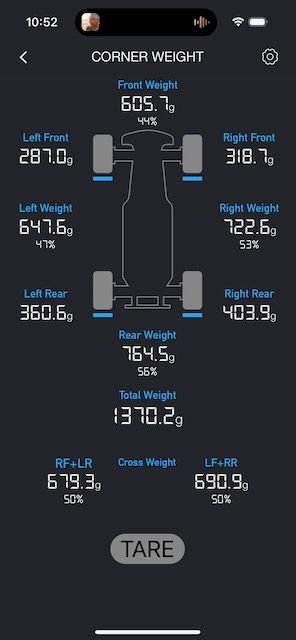

River19 04-06-2024 09:14 AM
Since I cannot get to the track for a few days I have been setting up both the TT-02 and my TLR this past week. I did some additional work on the TT-02 as while I was able to get the balance better a couple days ago, I was still front-high vs. the rear. So I had to swap back the rear shock mounting positions to get back to where the rear is slightly higher. I was able to swap out rear springs to a.lighter set, which allowed a little more sag in the rear and I think that will also help the rear end hook up a bit better under power.
After the spring and shock position swap I then rebalanced things with pre-load......and here is where I landed and where I will start next week's race night for setup.
https://cimg7.ibsrv.net/gimg/www.rct...7bc2059f8.jpeg

I know that feeling.. you been tinkering.. not being able to get out and try it on the track… the suspense.. definitely let us know how it goes when you finally get it out to the track🖖

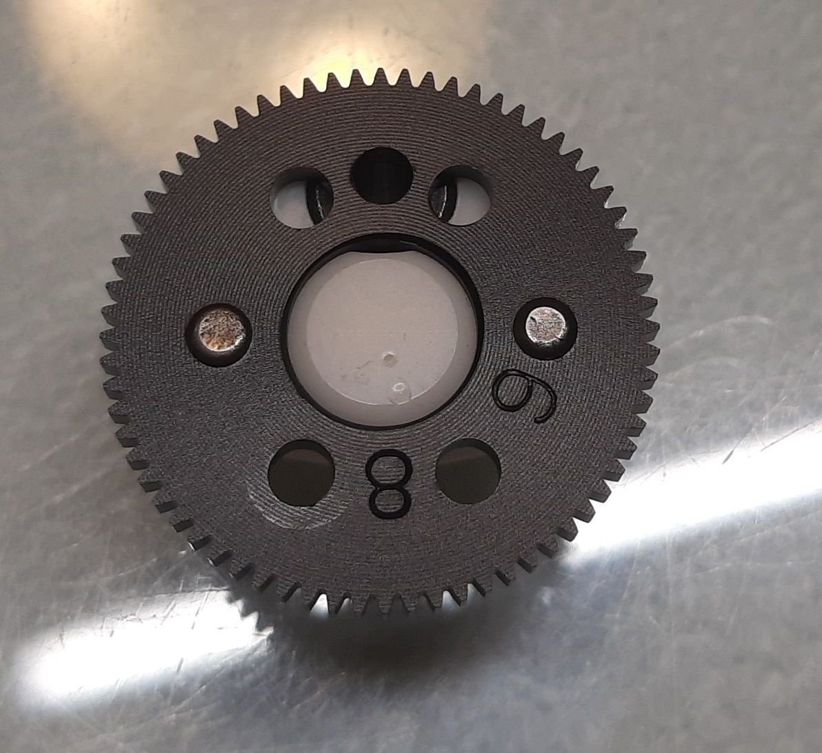

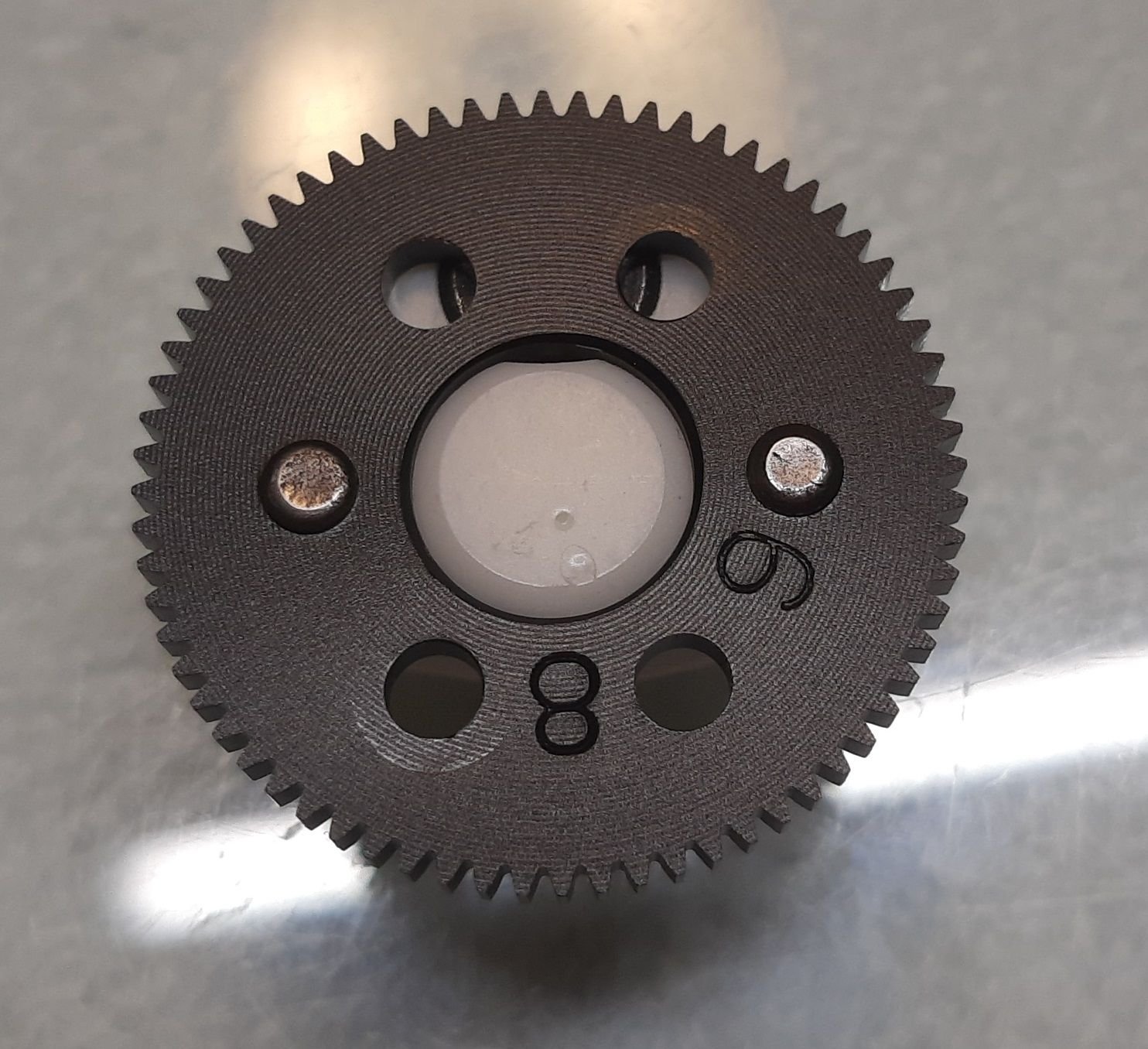

Needed to drill some holes in these RW gears because only 2 lined up, they would have held just fine but that's not as fun as making a tool to add 2 more!
https://cimg1.ibsrv.net/gimg/www.rct...2ae4469401.jpg
https://cimg2.ibsrv.net/gimg/www.rct...19f614fa93.jpg
https://cimg3.ibsrv.net/gimg/www.rct...f229149ac4.jpg
