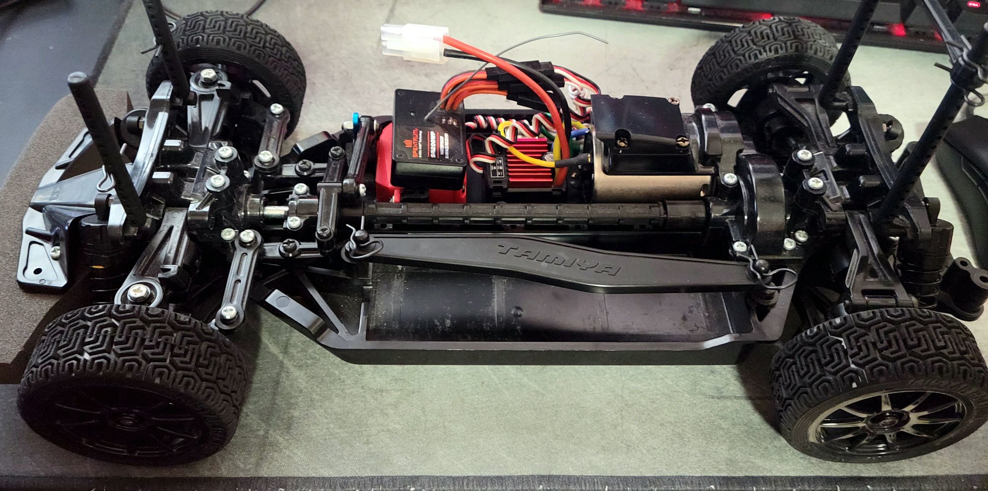

Here is another stock TT-02 that I'm upgrading to a fun racer/basher/possible rally car. Red is the theme on this car.
- servo = ARMMA ADS-5 (AR390133) - plastic gear servo
- esc = Hobbywing Quickrun 1060 - 2s or 3s brushed
- dampers = Tamiya 53155 (https://www.tamiyausa.com/shop/optio...n-alum-damper/)
- wheels = Tamiya 84253 (discontinued)
- battery = Venom Reaction 50c 2S 4000mah (old battery)
- *suspension = Tamiya 54874 Adjustable Upper Suspension (https://www.tamiyausa.com/shop/optio...per-arm-set-3/)
(EDIT - I posted incorrect information about using the Adjustable Upper suspension. Thanks SIMPLE for pointing this out. Here is the correct info from Tamiya USA)
• Compatible with TT-02, TT-02R, TT-02RR and TT-02D chassis cars.
• Cannot be used with Item 54639. If using with Item 53792, use Item 42236 for adjustment.
Tamiya 54639 (https://www.tamiyausa.com/shop/optio...-stay-front-2/) is a discontinued Carbon Damper Stay Front (shock tower).
Tamiya 54947 (https://www.tamiyausa.com/shop/optio...amper-stay-ii/) is the current version of the Carbon damper Stay that can be used on the front or rear of a TT-02/TT-02R/RR or TT-02D. The TT-02 S models have their own version of a FRP or carbon fiber damper stay and adjustable camber links.
Sorry for posting incorrect info earlier.
I probably will throw a red Yeah Racing 30mm fan on this kit for cooling. Not much more red the car really "needs". There is a red hard Tamiya TT-02 chassis that comes with the Mazda 3 kit (58671-A - https://www.tamiyausa.com/shop/110-4...t/rc-mazda3-2/). Yeah Racing makes a couple of different red upgrade kits but I really don't want to spend that much. There are a few other companies that make a red shaft and red steering that are much less expensive
Still figuring out how I want to clean up the wiring and if I want to mount any electronics in the battery tray (shorty lipo)

Originally Posted by IndyRC_Racer (Post 15983689)
* You cannot use the stock cup joint/dog bone/axle with the 54874 upper suspension. I upgraded the front to steel universals/cups. I upgraded the rear to use steel cups/shafts/axles.
That is not a correct statement.
The kit is compatible with TT-02, TT-02R and TT-02D chassis cars.
I use the upper arm kit on my mostly stock Subaru Rally

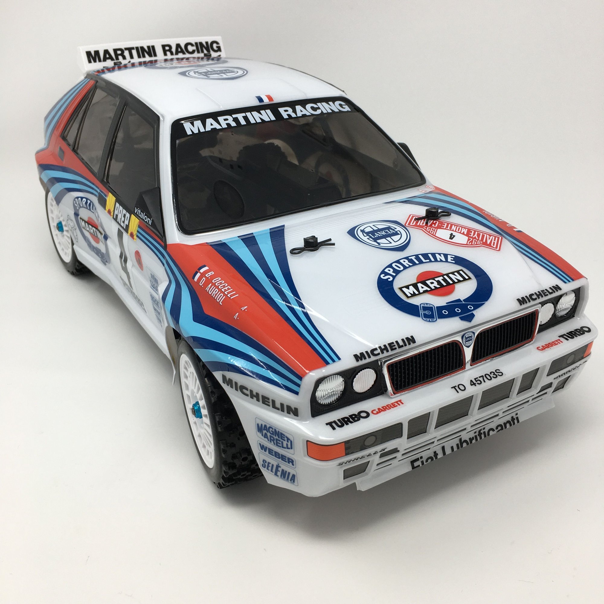

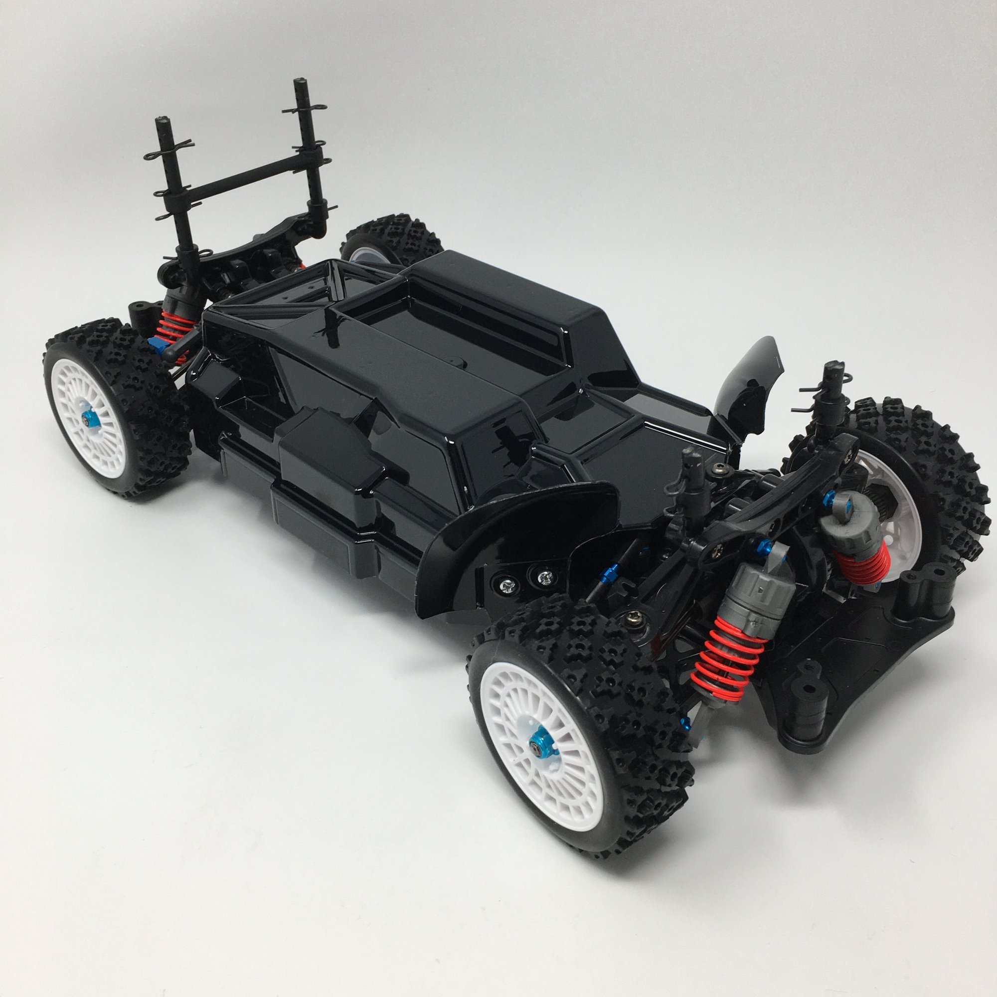

Just completed this addition to my collection. Bring on the Dirt!

Raman 02-24-2023 03:57 PM
One of my all time favourite Tamiya bodies. They should do an update and add option for real light to it
IAmGreatDane 02-24-2023 09:00 PM
simple How tight does the chassis cover sits above the spur gear?
I see you have opted for the The RC Racer TT-02 prop shaft holder. At least that what it looks like to me :-)
Thanks.
simple 02-25-2023 11:37 AM
Thanks.
well clear, not even close.
IAmGreatDane 02-25-2023 02:21 PM
Thanks.

Hope this information is helpful.
https://cimg4.ibsrv.net/gimg/www.rct...026e79703f.jpg
https://cimg8.ibsrv.net/gimg/www.rct...5470d216a1.jpg
https://cimg0.ibsrv.net/gimg/www.rct...27fc57cf01.jpg
