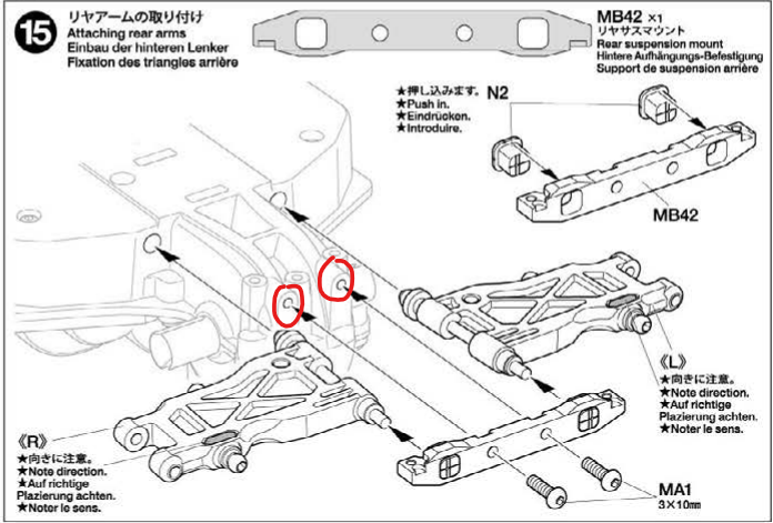

What I've experienced the last time I drove the car however, is the fact that the chassis break where the rear toe block is attaching to the chassis :
https://cimg5.ibsrv.net/gimg/www.rct...2c8ab6f4ca.png
I did not have a huge crash but I suspect the constraints being applied there made the fixing holes split and the rear suspension fell apart. I'm thinking either of using the lower part of the front bumper holder (B8) at the rear to offer some kind of additional support there, or (more likely) design a small carbon plate to fix on the existing 3 holes at the bottom of the chassis and long enough to support the bottom of the MB42 part.
What do you think of that ? Did anybody experienced this kind of issue ?
Regards,
G-rem
IndyRC_Racer 01-10-2025 11:32 AM
I have experienced the chassis holes splitting where the front/rear suspension plates are mounted (see pictures in the previous post). I've had this happen multiple times on my S/SR spec kits.
Here are the reasons why this happened to me.
- Installed the screw at an angle/not straight.
Make sure to pay attention when screwing in the 3x10mm machine screw into the plastic. If possible use a thread forming tap before installing screws. This will make it easier to install aluminum/titanium M3 screws into the TT-02 hard lower deck. Here is a link to Tamiya 54232 (Rc M3X0.5Mm Thread Forming Tap)
https://www.tamiyausa.com/shop/optio...d-forming-tap/
- Used the wrong length/too long screw to attach Tamiya 54967 (adjustable rear toe) when replacing Tamiya 54637 (3 degrees fixed rear toe).
In my case I was switching from the fixed 3 degree rear toe mount (3x15mm screws & DOES use the plastic rear bumper) to the adjustable rear toe mount (3x10mm screws & DOES NOT use the plastic rear bumper ). I didn't notice that the screws used for the 3 degree mount were longer than the adjustable mount. When installing the new mount without the bumper, the longer screws stressed the plastic which inevitably led to it cracking from a collision to the rear of the car.
Please refer to the pics in his post of an S & SR kits for the differences in the rear mounts.
A simple solution to make the rear end more secure on a TT-02 SRX (when using internal droop limiters in the dampers) is to slightly modify the plastic bumper so that you utilize the 3 holes on the bottom of the chassis (under the diff case). This will require removing a small amount of plastic where the rear bumper contacts the rear toe plate, but it should be easy to do with a hobby knife of a rotary tool. You could even go one step further and use longer M3 screws to attach the plastic bumper through the rear toe plate (similar to the TT-02 Type S kits). The only drawback to this solution is that it will require removing the rear bumper to service the rear toe/suspension arms on an SRX kit.
