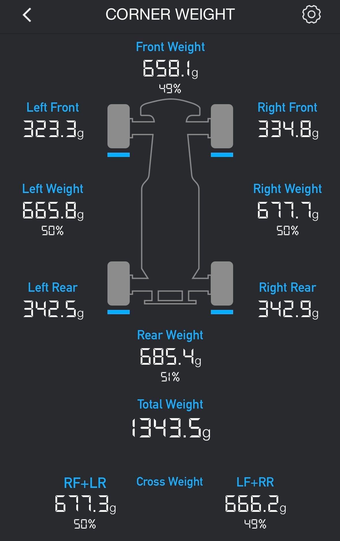

- Is the car balanced side to side?
Damn near perfect. See the scales picture. Better than most my X-ray are. Cross weight is 50/50. F/R weight is 47/53. F/R is 11g (3%) heavier than the F/L. L/R is 1.6g heavier than R/R.

- You cross weight/corner weights look off in your earlier post. It is very close. I tried using the thin preload spacer on the R/F to cause a little more push on left turns and the car pulled to the side under acceleration and it didn't stop the cornering issue.

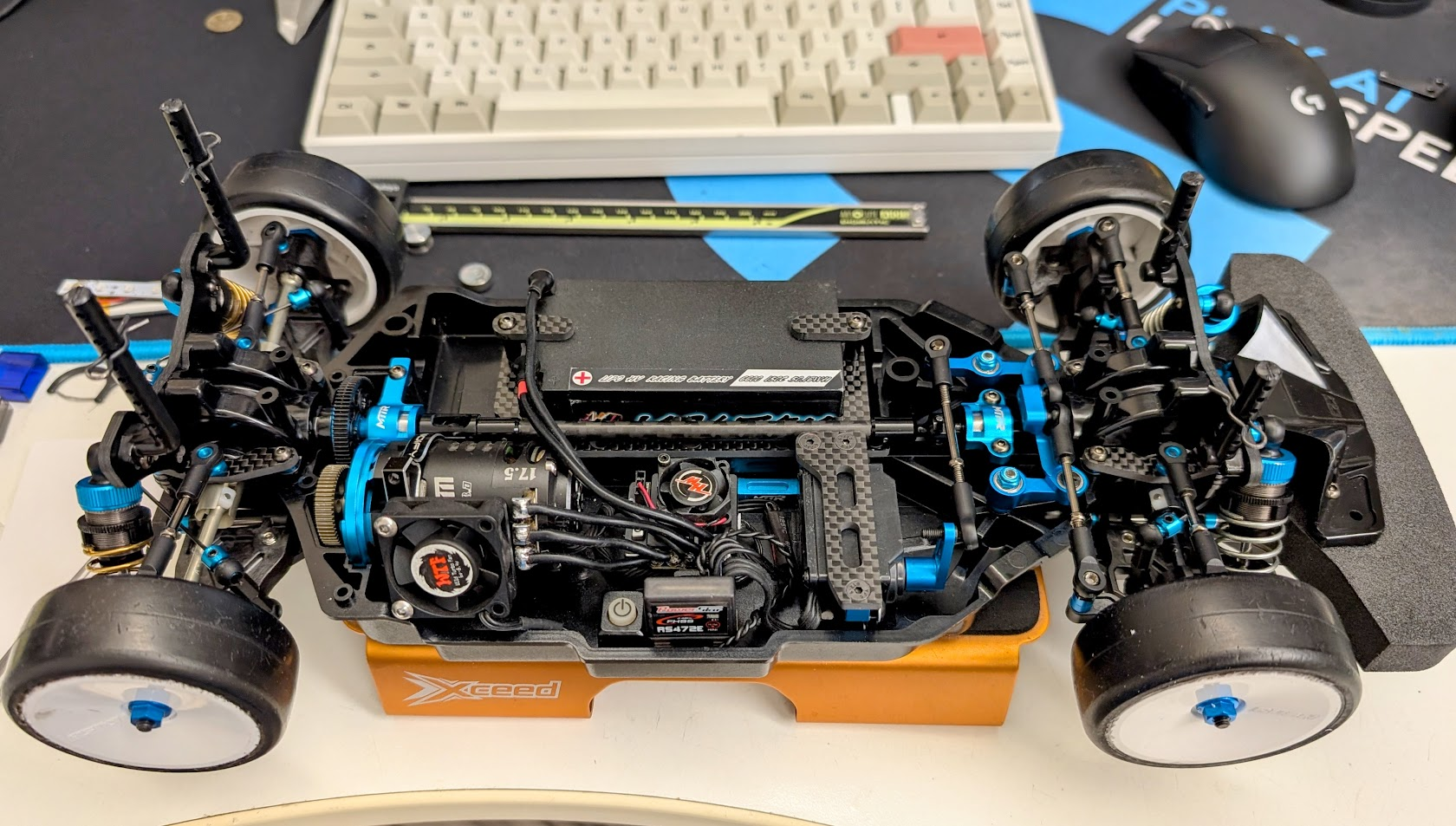

TT02-SRX
https://cimg9.ibsrv.net/gimg/www.rct...c79e845b6e.png
chjosi 06-22-2025 08:49 PM
Originally Posted by disaster999 (Post 16195614)
17.5, for serious? Can you share more build details? The shaft, bearing holders, shocks, etc.?
disaster999 06-22-2025 09:12 PM
Pretty much threw a bunch of MTTR parts on the car, relocated upper link mount, sway bar, downstop plate, shorty battery holder, front and rear shaft bearing mount, motor mount, and floating servo mount. Tamiya steering link and the shocks from the TA08 since Im not running that car at the moment. carbon shaft is from 3racing
And yes, 17.5T, thats how we roll here. Running ~3.5FDR right now but the people here are all running 4.0FDR so gonna switch it up.
