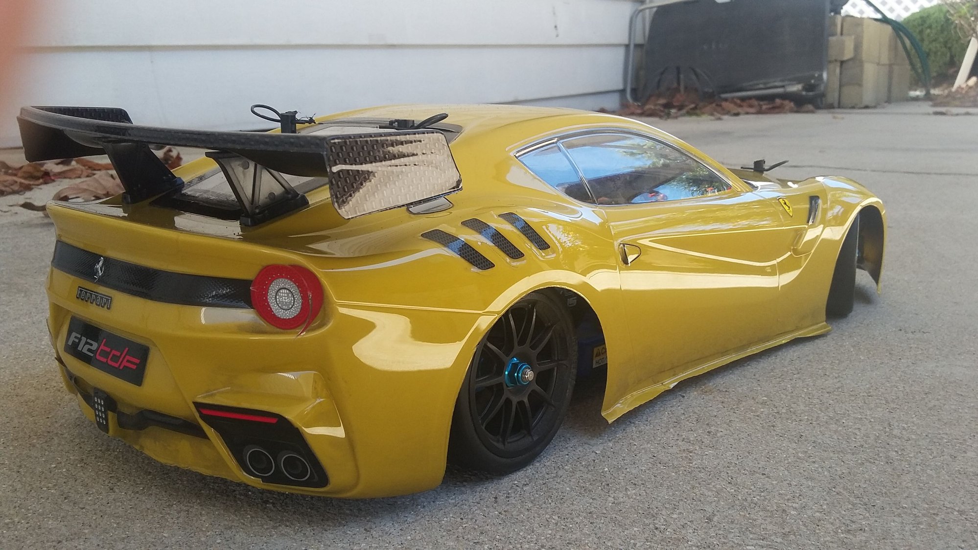

BmainStar 07-16-2019 12:08 PM
Toy car
Here is My tt oh twohttps://cimg0.ibsrv.net/gimg/www.rct...d26231f5e5.jpg
https://cimg9.ibsrv.net/gimg/www.rct...7938bbf0e7.jpg

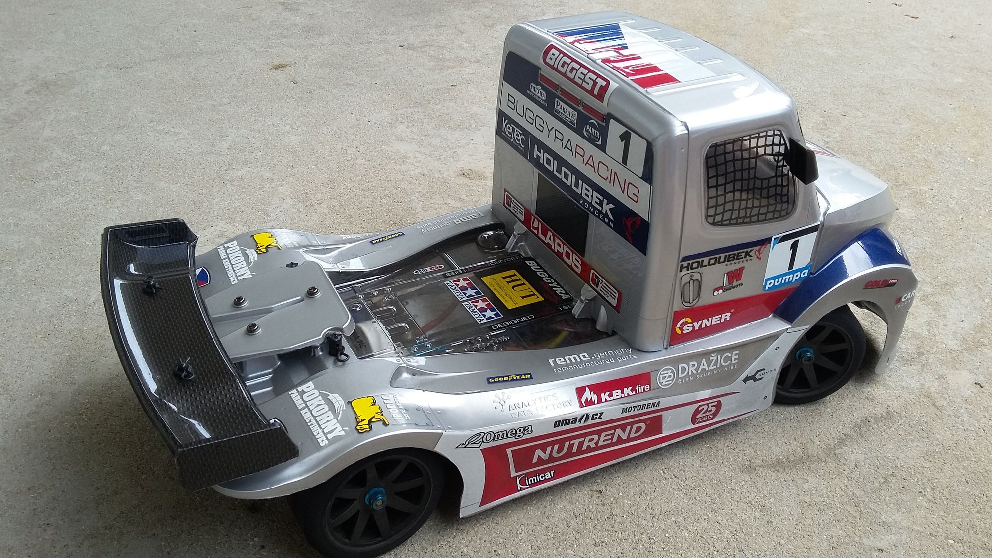

BmainStar 07-24-2019 01:06 PM
The new body I just did for Etrk and the tt02 I just built have fallin in Love, .... it's SiCk.
1st runs out front shows real well.Foam Tyres and rear wing calm the rear well.Which I was having an issue with on corner exit ,throttle on power.
Try get it to the track Sat.
17.5 mtr.https://cimg3.ibsrv.net/gimg/www.rct...d20be43084.jpg
https://cimg0.ibsrv.net/gimg/www.rct...a40df7aedb.jpg
