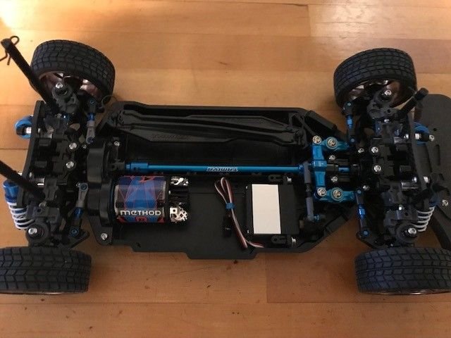

From: Nashville, TN

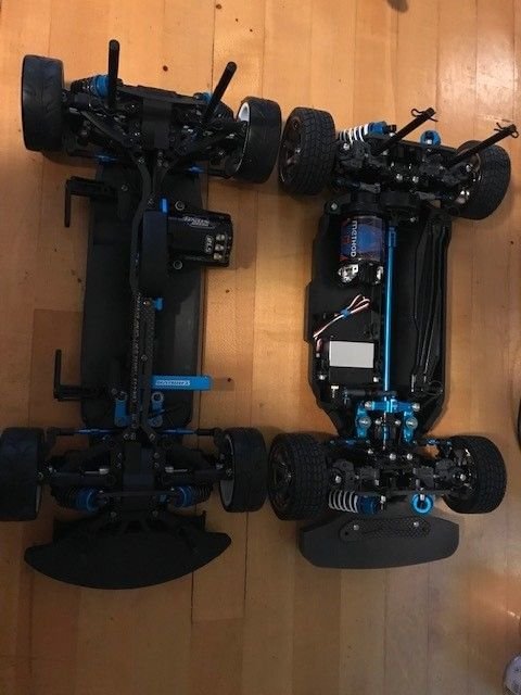

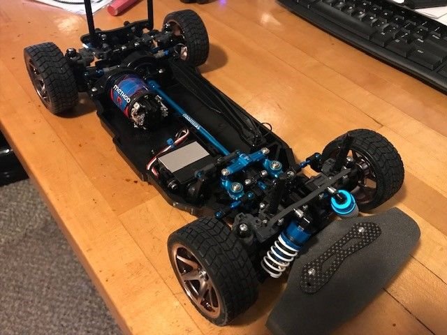

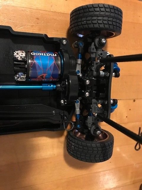

Here are the active rear steering mods. You need Parts bag A, B, Adjustable turn buckle kit X2, 18mm shaft and ballcups ( I used ones from TT-02B shock )
