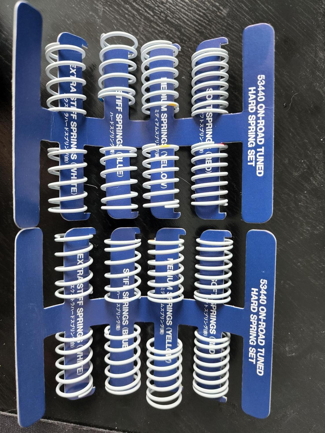

Thanks for the tip on the drilling the cap. Are the TRF shocks any better than the Yeah? For my level of racing I highly doubt it.
When I used the TRF springs on the Yeah shocks I could not obtain the ride height. Standing the spring next to each other the Tamiya was a coil or two longer. When I get home I will take a picture.
I found the Yeah Red on the rear and yellow up front worked for a starting point. Using 500cst oil. Sunday I plan on doing a club racing. I will see how it goes.
So far the only issue I have had was a bent turnbuckle in the upper front adjustable arm. I was able to replace it with a Ti one from an xray t4 kit I found. Hopefully that will tighten up the front a little.

Sorted the spring issue out. I did not know Tamiya had so many types of TC springs. The one I pictured above is the right one. I ended up using the Yellow (medium) for the front and a Blue soft from the 53163 road rally spring set.
