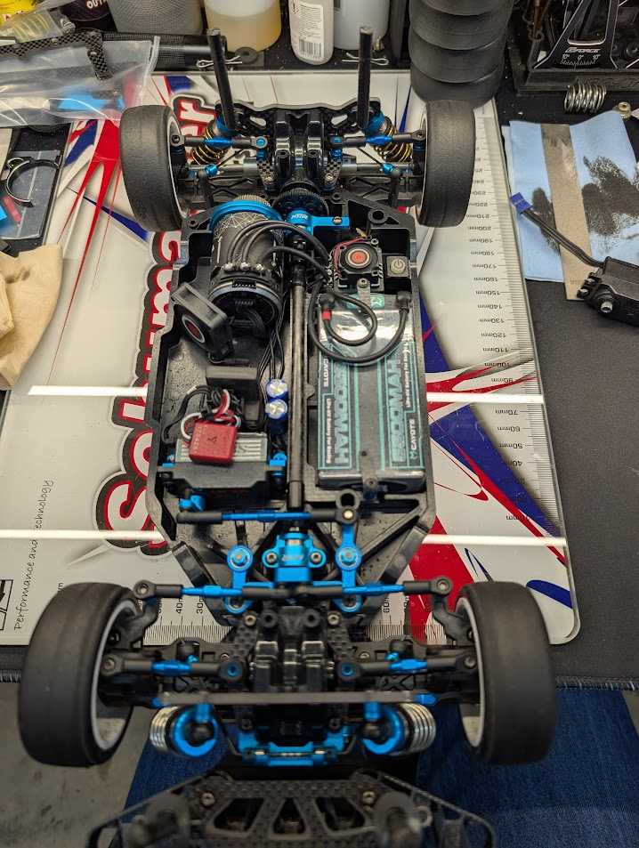

Ive ran the car with electronics on one side and shorty battery on the other and the motor side is almost always going to be heavier. I put the car on balancing pins and deliberately tilt the car to the battery side just to watch it teeter back to the electronic side. Im not running super light weight battery, a big or heavy ESC or have heavy gauge wire either. Just a Hobbywing XR10 stock spec with 16awg wires and a 5500mah battery weighing around 200g.
After moving the ESC over next to the motor and having the battery up front the balance is more even left to right.

I ran the car with battery on one side and electronics on the other for a while and honestly the car handled fine, MAYBE its a little more sluggish turning left than right but I honestly didnt really care. I was having too much fun just running the car on the track with friends. After moving the ESC to the battery side, the car drove very similar to before, maybe a bit more balanced and easier to drive.
I never tried putting the battery to the rear and having the ESC to the front but keep im mind with motor wires reaching that far, it will undoubtedly tub against the center shaft and cause issues down the line.
With my setup, the car weights under 1100g without the body, and under 1350g with a tamiya body.
