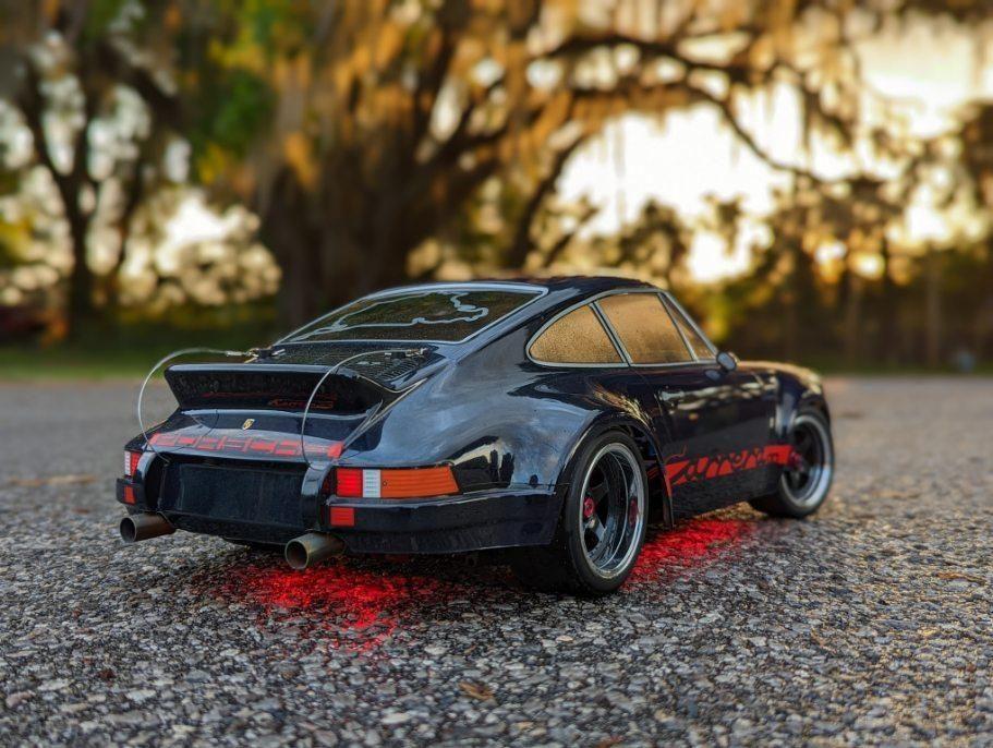

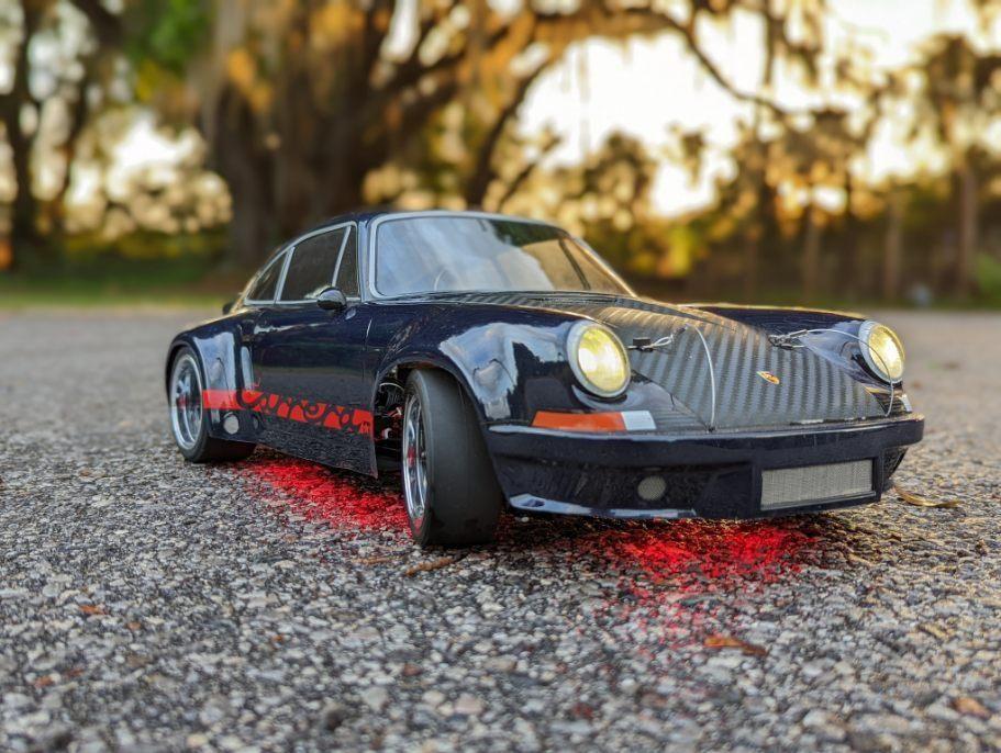

Default Suppose it's about time you all get to finally see the guts of the 911 RSR build
So here she is, with my latest design implementation.
Underglow with 14, 180 degree, flat top 5mm red LEDs. They are on a separate harness from the headlights and tail lights, and draw less than 300ma. All wired in parallel. Each section has a plug. The bumpers and both side pieces. I designed and 3d printed the sides, and just drilled a few holes in the bumpers.
I'll try to get pics when its a little darker out, but the light covers the entire underside of the car and it looks good! At least to me it does LOL. I know underglow isn't for everyone, But I wasn't happy with what was available to add underglow currently.
I'll probably do the wiring better on the next set and maybe make a cap to hide the wires on the sides.

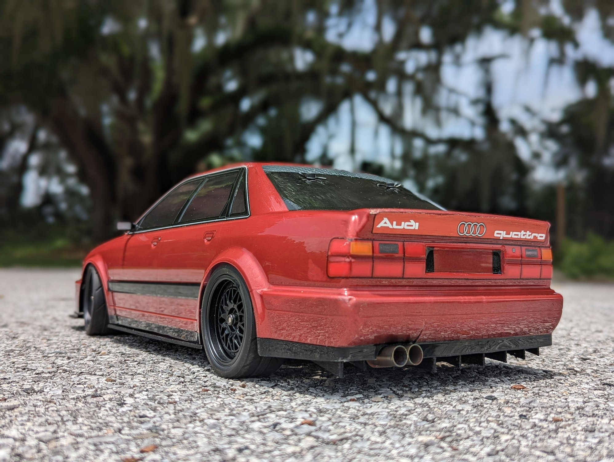

Default The budget TT02 chassis/1991 Audi V8 Throwback
Full aero underkits designed for 2 bodies now. The 1991 Audi V8 and the Lancer Evo VII Tommi body.
Diffusers here for the Audi (may fit other bodies, Mounts to the rear bumper plate so can't use it with a rear bumper assembly). https://www.thingiverse.com/thing:5392178
