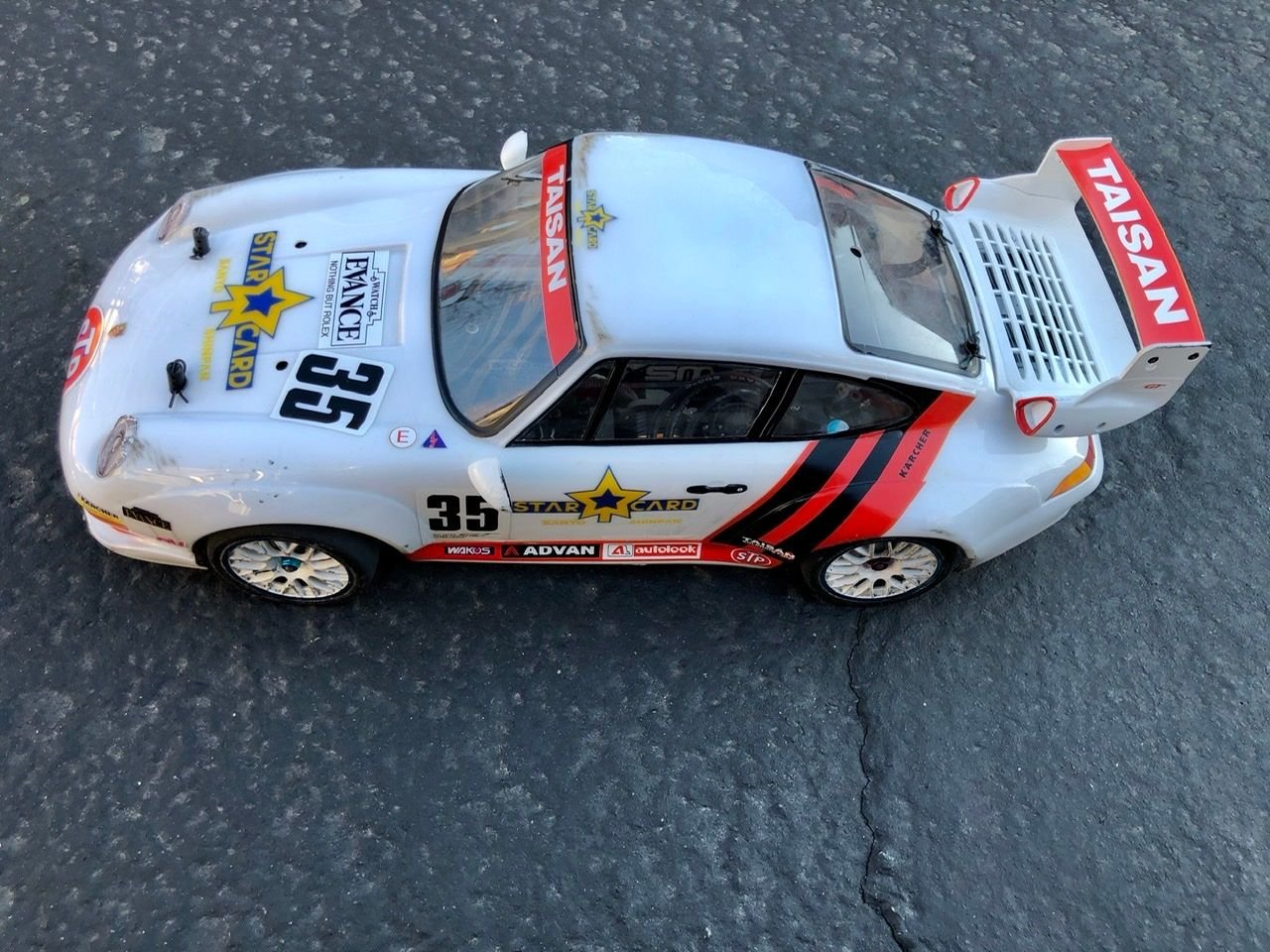

Raman 11-09-2021 02:54 PM
This is my TA05 V1 60mph car.

TurboThirdGen 11-09-2021 03:06 PM
