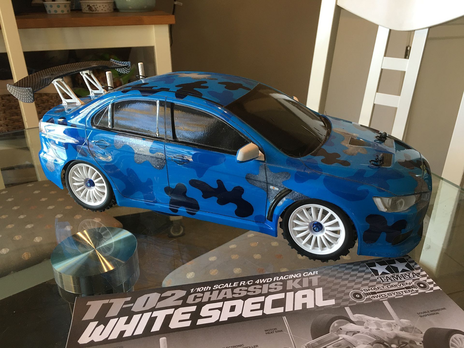

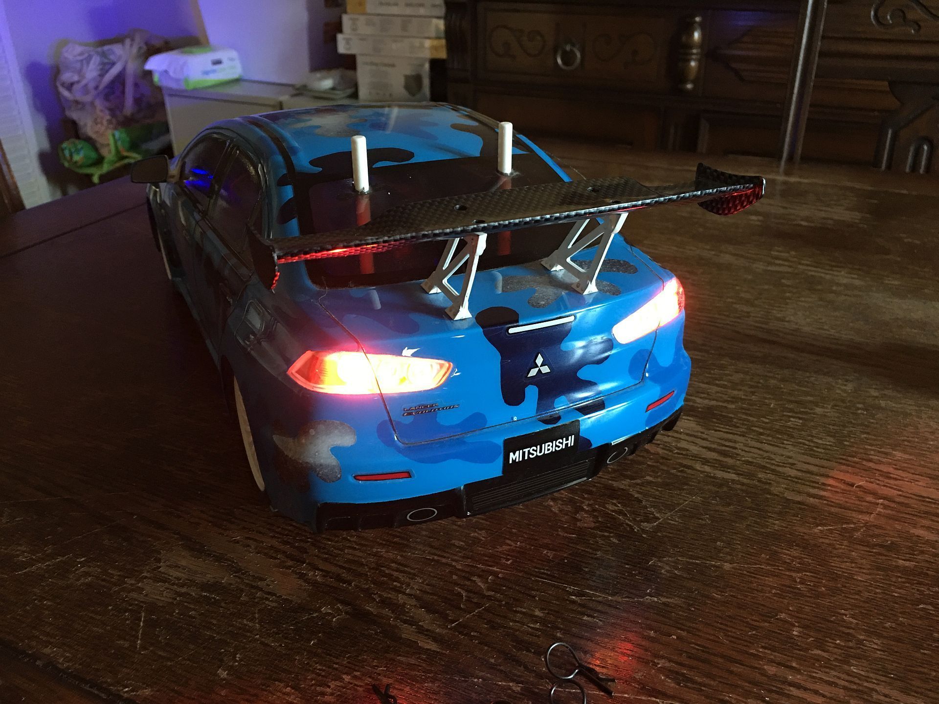

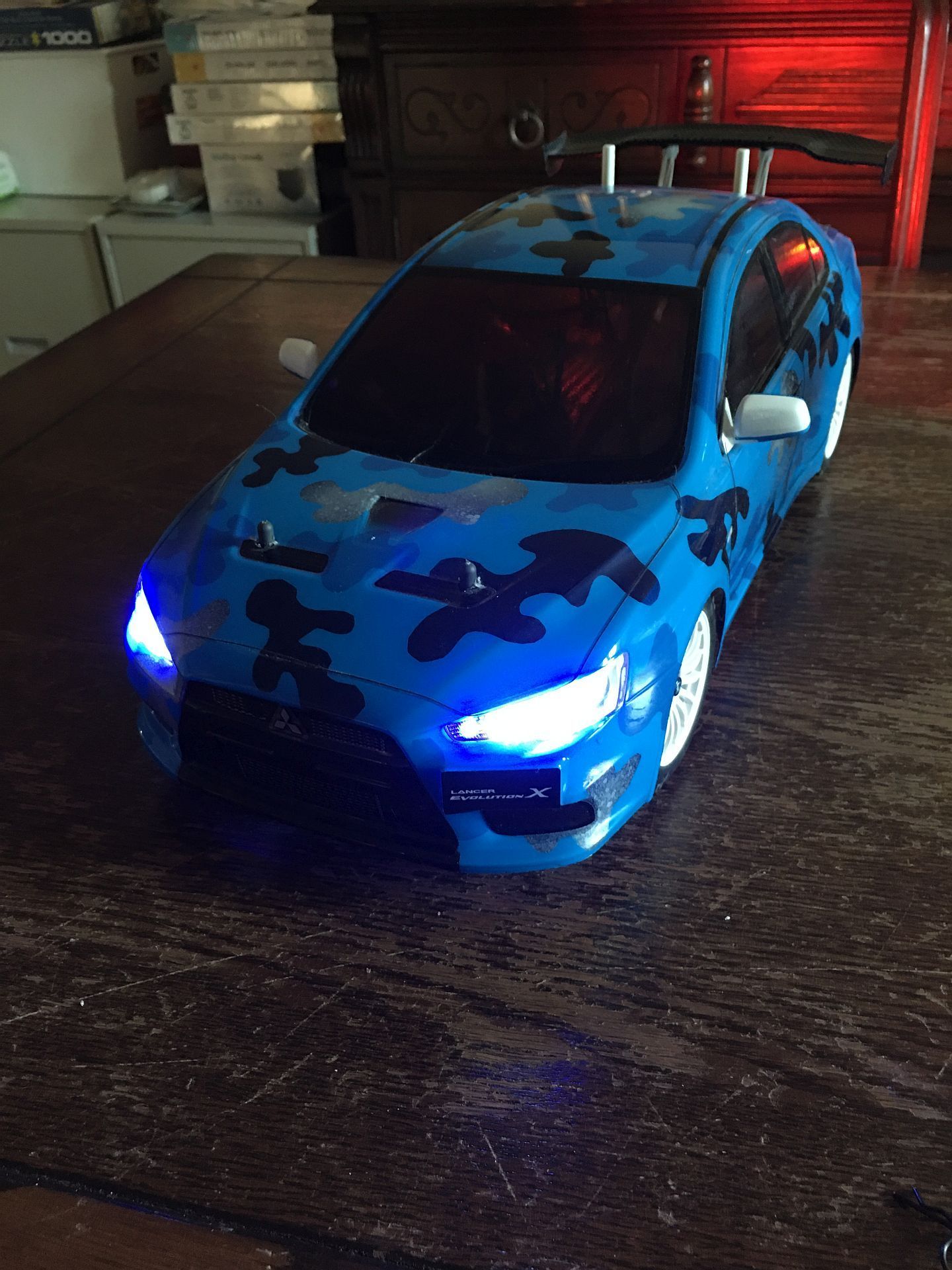

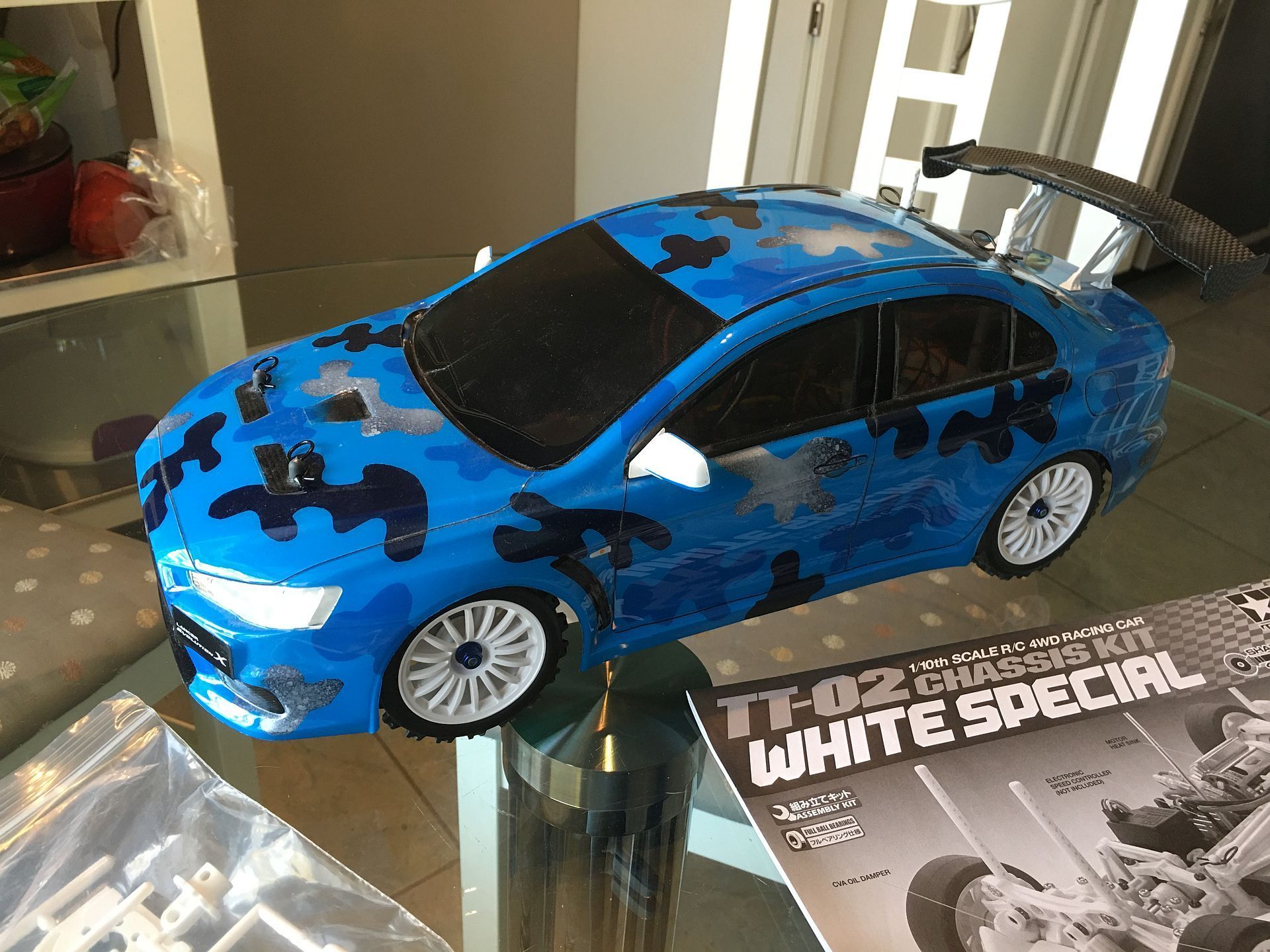

I picked up another Tamiya TT-02 this morning, this time a White Special built but never run with the silver can motor and Tamiya ESC as a rally car with the Mitsubishi Lancer body . The blue camo colour scheme and striking looks nice. The previous owner had installed a YR light kit in the body and everything checked out perfectly. Just need to glue the tires and she's ready to attack the dirt trails.

Raman 11-07-2021 06:03 PM
White chassis on dirt? That’s a bad combo 😂😅
SteveM 11-07-2021 06:21 PM
I know, seems odd to me too.
