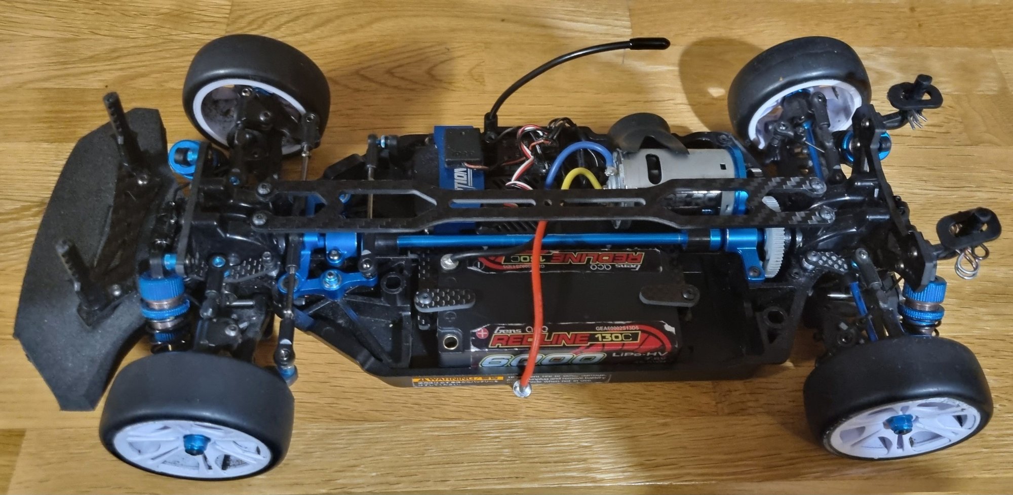

My tt02sr raced in koc gt and now aldershots supersport class holds fastst qualifier at moment shore will go next year when drys up lolhttps://cimg5.ibsrv.net/gimg/www.rct...35d53cab41.jpg
https://cimg6.ibsrv.net/gimg/www.rct...e9892160fe.jpg
