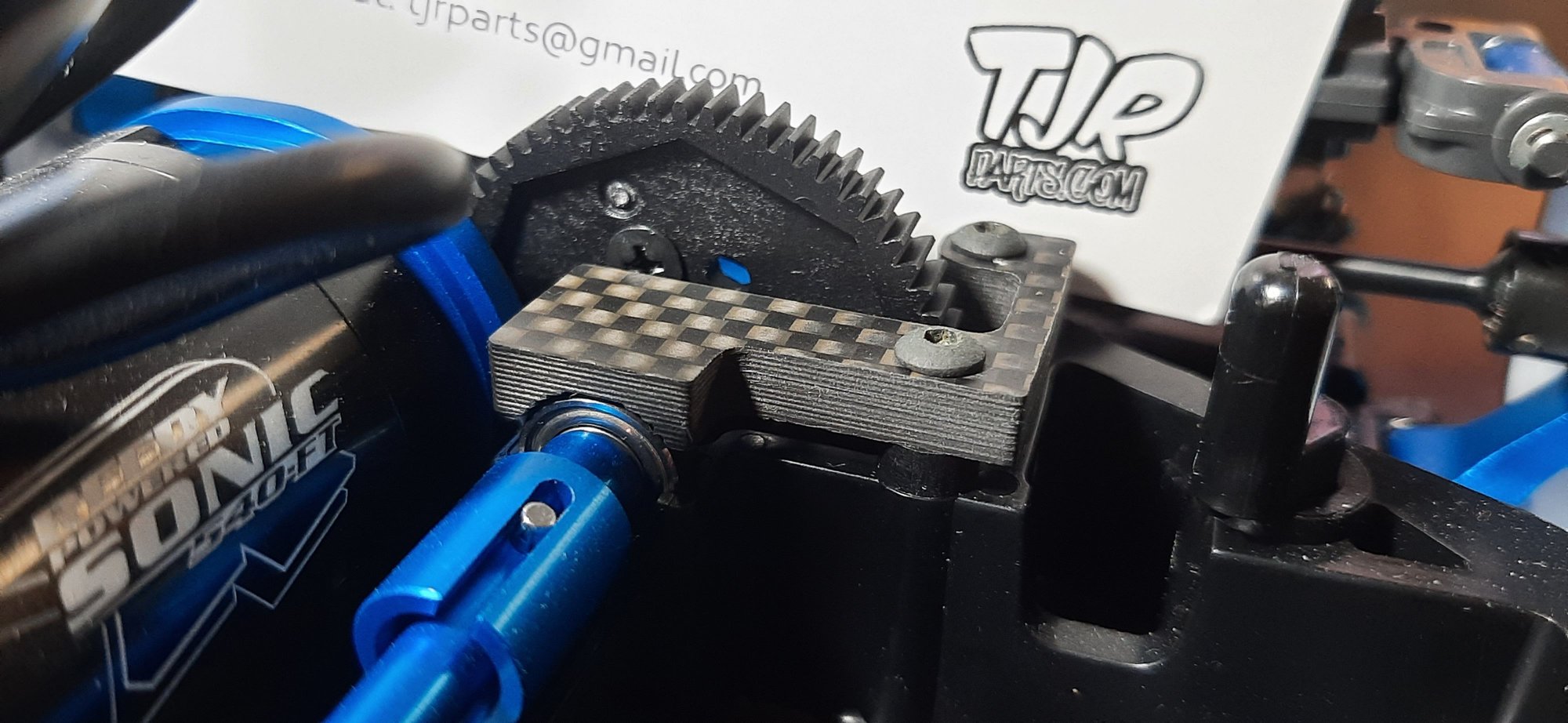

PROMODVETTE 12-01-2023 11:17 AM
I gotta admit, the TJRparts.com gear cover replacement is dialed!! He even has a channel milled for the bearing. https://tjrparts.com/products/tt-02-gear-cover-delete
