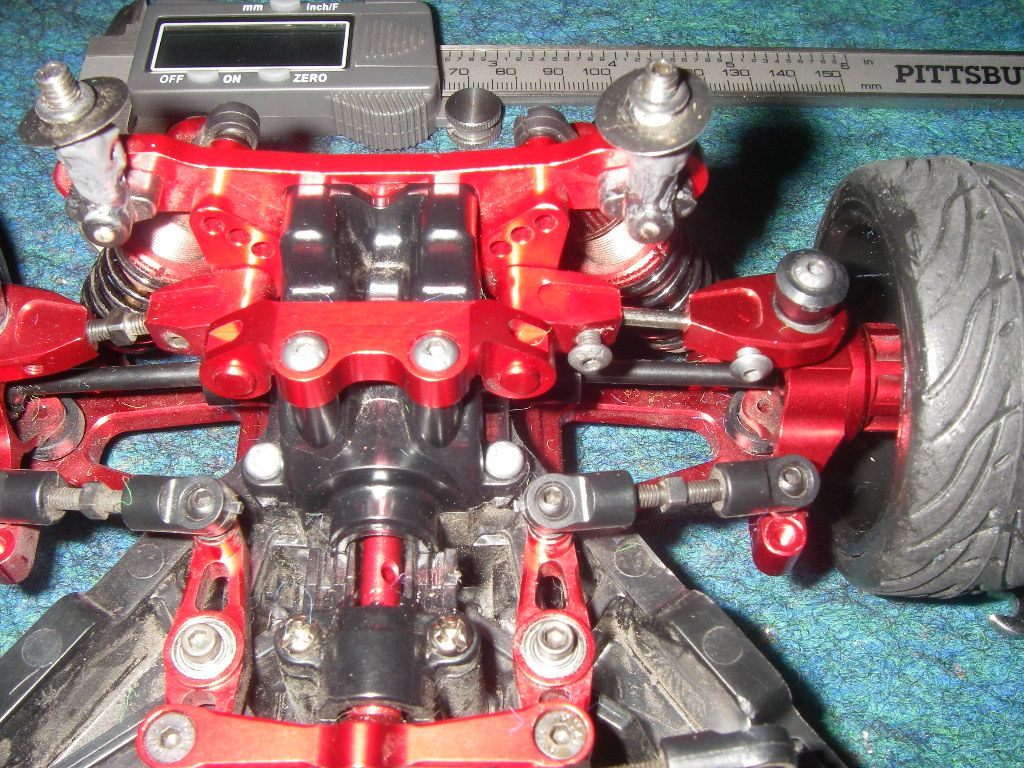

How did you extend the ball cup in the steering bridge? I also need the linkage to be in horizontal. If I don't put spacers in the bridge it's angled. And the steering radius is not even.
It is all just shims in combination with the Tamiya servosaver.
Can you post a picture of your steering setup, please.

Hey wtcc,Tell me about your turn buckle set up.
I notice an Alum bridge /diff mnt that ball cup attaches to.I know You make some parts too.
Set up looks way better than the one I have
Thanks, Ric

Whats the code of your kimbrough servo saver? also is it large or medium?
wtcc 11-22-2019 02:57 PM
The car consists of original Tamiya parts only.
I really don’t know what I did different, but here are more pics of the steering and front of the car:
https://abload.de/img/1a95ff3d-6350-409a-88djgi.jpeg
https://abload.de/img/d422236f-ca3c-4995-8yxjj6.jpeg
https://abload.de/img/b8dd9d1e-eb14-455f-boxk6z.jpeg
Thanks, Ric
That is Tamiya part: 54651 ;)

If you look at thercracer website in his guide he talks about steering for the TT02 and the parts needed to get what you're looking for.
Bear in mind it used to be that you needed to get several different hop ups to make it work but you don't anymore.
Tamiya #54752 has all of it. It's way cheaper than buying the individual pieces separately.
I actually let Craig/thercracer know and being the a cool guy that he is, he's updating his site.
Seth
What type of screw did you use? Is it really long?
Nerobro 11-23-2019 08:08 PM
They make some really long setscrews. That looks like the nut ballstud, so I supsect there's a 15mm (ish) setscrew in there.
wtcc 11-23-2019 11:41 PM
They add the screws in the parts bag. And yes it is very long :lol:
