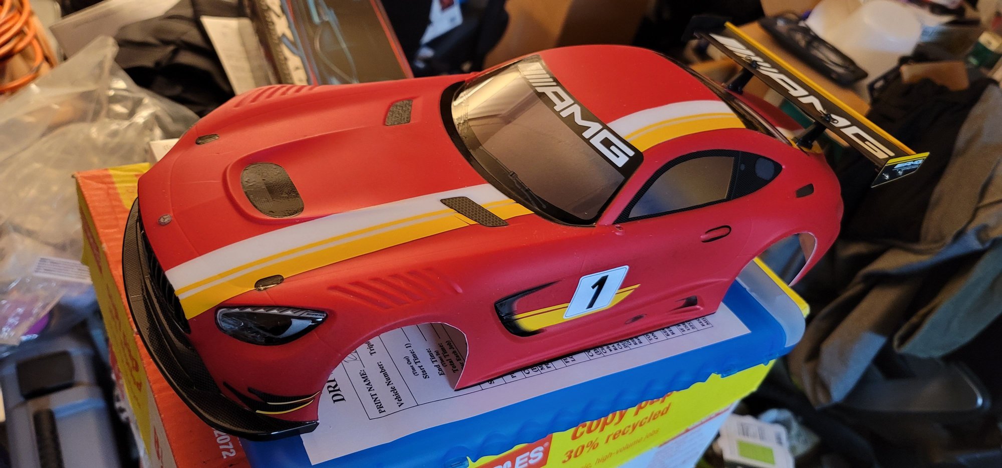

Almost finished with the body food the TT-02 kit I'm giving to my step-dad. He said he's ready to build a kit, but I also know he'd have no patience in doing the body (and, considering I've already spent a good 15 hours on it, NOW I understand what perks mean about Tamiya bodies being "complicated". Anyway, here's what it looks like so far.
https://cimg1.ibsrv.net/gimg/www.rct...81e5e10aaf.jpg
You used flat paint it looks like? That looks really slick man!

Panther6834 11-13-2021 10:05 AM
Originally Posted by TurboThirdGen (Post 15843808)
You used flat paint it looks like? That looks really slick man.
Yes...and no. Used standard Tamiya PS & Traxxas ProGraphix paints on the inside. Then, using my scalpel (I don't use X-Acto knives), I carefully...and, very lightly...cut the overspray film around the areas needing to remain 'glossy' (windows, headlights, taillights, front & rear air dams), and packed away the overspray film (except in the aforementioned areas. I also left the tape covering the windows, headlights, and taillights on the inside. After that, I sprayed Traxxas ProGraphix flat clear, waited for our to dry, and finally removed all (exterior) overspray film & (interior) tape. Just a standard "trick" for creating 'flat' paint jobs. My custom-painted Losi Baja Rey body, as well as both of my Spec Slash bodies, have all received the same treatment.
That's pretty cool. I was thinking something similar just didn't know that was a thing! It looks really good like that.

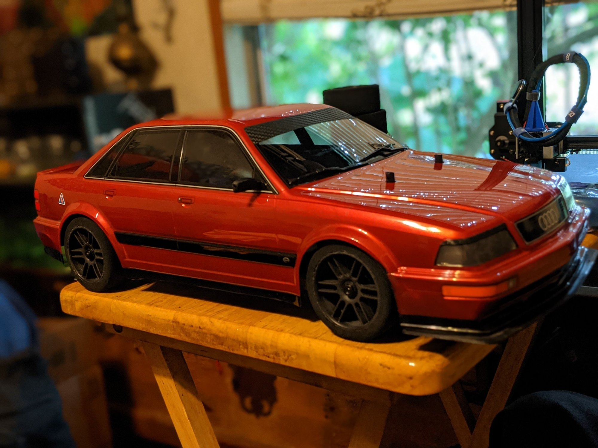

I've retired my GTR34 body and started using my 1991 Audi V8 body painted stock instead. Almost ready just waiting on the mail to come so I can add a little rear toe! Straight enough to try 3s again. Last time it fragged a cheap eBay wheel at like 50something lol. That was a crazy roll and somersault.

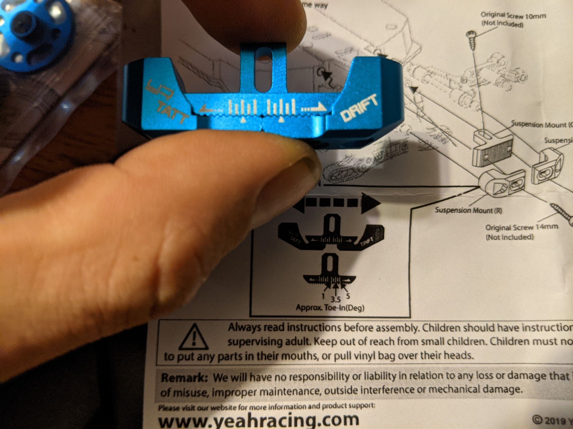

So this is pretty dumb, but I got the Yeah Racing rear toe plate. And the only way to get less than 3.5 degrees of toe in, you have to grind some rather large chunks off. Even though the instructions show the inside most lines are 1 degree of toe in, there is no possible way to achieve this with the toe plate.
Just thought I'd throw that out there in case anyone was interested.
https://cimg6.ibsrv.net/gimg/www.rct...fab91aa298.jpg
EDIT- Upon actually trying to use the piece I've discovered that it's only the lines that have been printed wrong. The inside most position appears to be either 1 or zero toe.
I'll throw it on the setup station to make sure.
