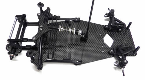

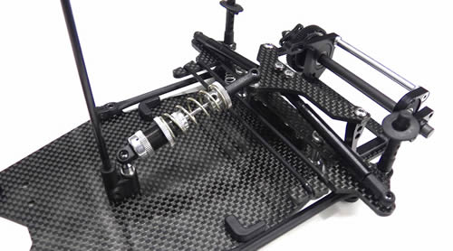

RSD-R12SS
http://www.reflexracing.net/RSD-R12S...an_p_2464.html
http://www.reflexracing.net/assets/i...rsd12ss_01.jpg

Okay X12 owners, We would like to introduce you to our transverse conversion kit. Comes with a solid 2.5mm chassis which consists of 3mm narrower front end mounting holes, 2.5mm upper top deck that moves the shock forward .250", a 3mm tweak plate that uses the o-ring style battery hold. Shock is mounted to the antenna mount and everything is centered on the chassis. Our testing has proven to be positive for 17.5 and 13.5 classes. We have not tested this in any mod class. Please visit our website for more info (http://www.diggitydesigns.com)
Some pics -
Some pics -
