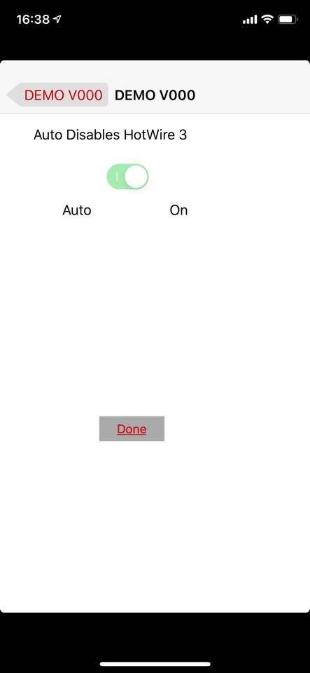

I got this gorgeous Hot Wire 3.0 Bluetooth for my RX8 Gen3.
The Fan set up can't do nothing, just stuck to ON. not move to Auto from the switch.
I got this most reason why I wanna change the fan option to auto.
How can I activate this fan option switch??
And what is this mean "Auto Disables HotWires 3"??

According to previous posts in this thread the fan must be set to on for the Bluetooth to work. The fan port provides the power to the Bluetooth module so any setting other than on will inhibit the Bluetooth connection. I think the inability to select auto is a software failsafe.

Also the picture you showed, your in Demo mode. Bind HW first and then you should be able to make any changes you'd like. Like sweems has mentioned the fan must be in the on position for the BTHW to function. I use it but I don't leave it on the vehicle and run it.

All the comments so far are accurate. Leave the fan in "auto on" so you can use the Hotwire 3.0 as intended, bluetooth connected.
