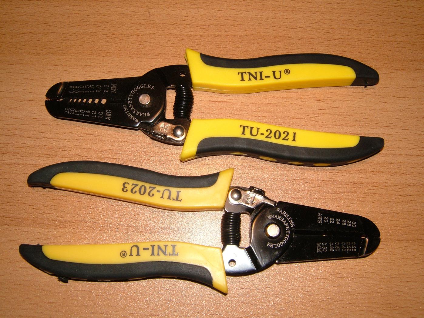

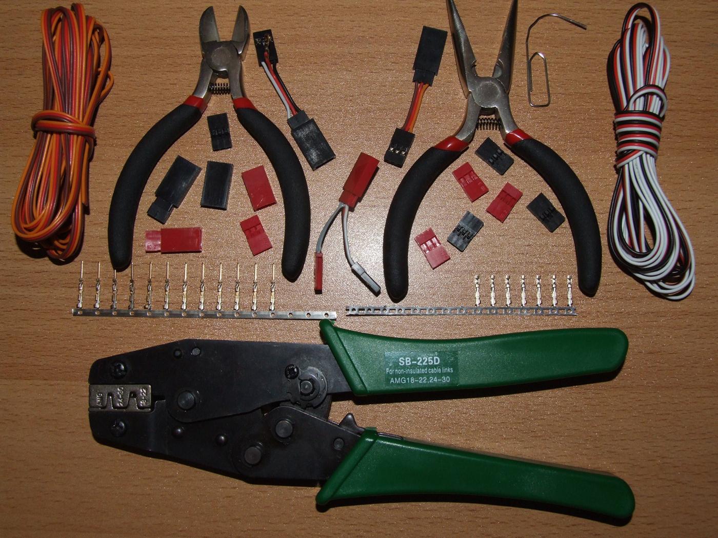

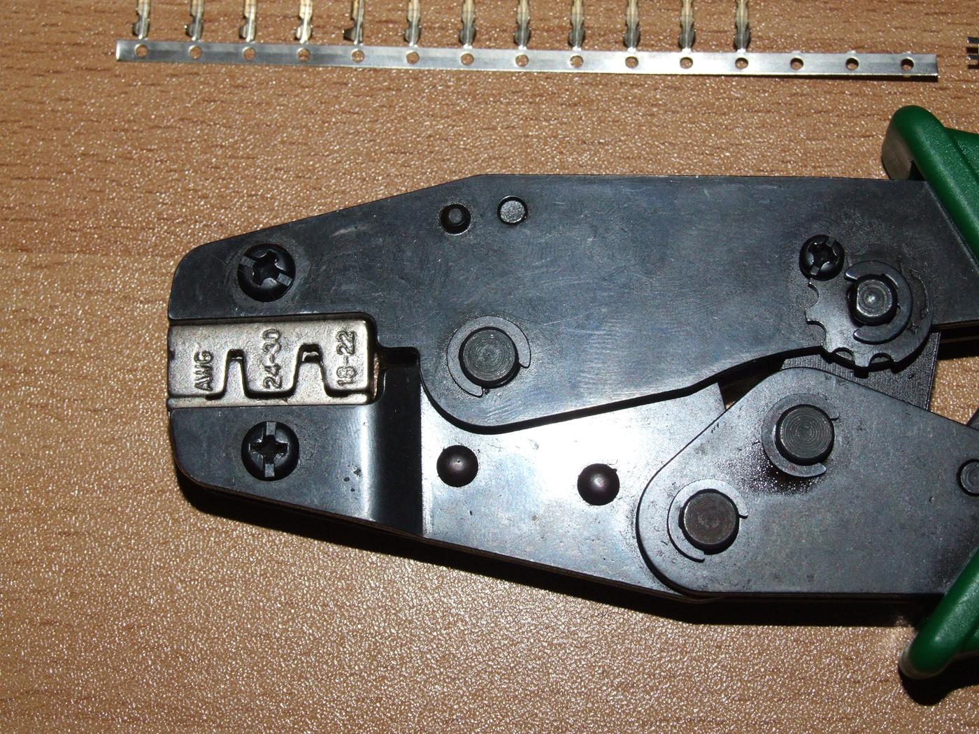

Well in my eyes the "right" way is to not do any soldering where the heat can travle up the leads and into the electronics which resides inside the servo housing... I may be wrong but that's how I see it.
So if you are to shorten the leads then you should do so using the right equipment/tools.
This is my selection of tools of which I use when I repair damaged servo leads or make new servo extension leads.
If one is to do any soldering it's important to have very good skills with a soldering iron and preferably have equipment where you can control the soldering tip temperature to minimize the risk of heat wandering up the leads.
Below is a short video of my soldering & rework station that I use on rare occations where I need to do some soldering. The temps displayed is in Celcius.
http://www.rcgalleri.dk/video/off-to...n_loddestation
Sorry the video is not on the tube for a better link. I hope you can live with it.
Hitokiri_2000 is offline
