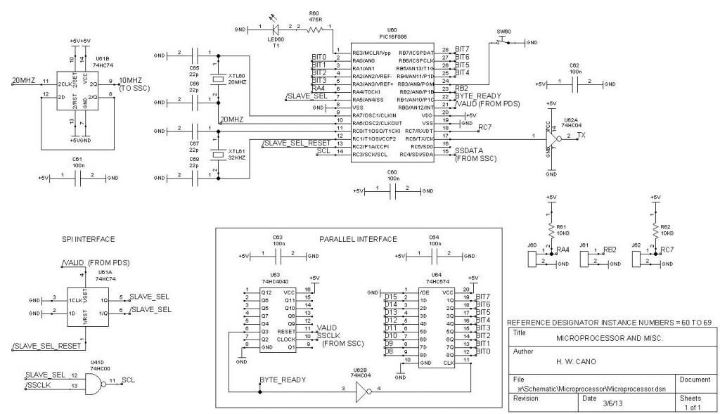

Here’s the schematic I promised earlier:
The microprocessor receives transponder data (stripped of the first two bytes by the Preamble Detector / Stripper, or PDS), timestamps it, and transmits the result as ASCII hexadecimal characters in asynchronous serial format to an external computer.
(Alternatively, I have also created software that recognizes a single transponder and calculates lap times for it, for use in testing and as a “Personal Lap Timer”.)
Microprocessor U60 runs at 20 MHz, as determined by crystal XTL60 and capacitors C65 and C66. (U60 is shown as a 28 pin PIC16F886; my prototype uses the 40 pin PIC16F887.) One of the internal counters runs at 32.00 KHz, as determined by crystal XTL61 and capacitors C67 and C68. This is used as a timebase for the timestamps.
U61B divides the 20 MHz clock down to 10 MHz for use in the Synchronous Serial Converter (SSC). (Thanks to Brano, “OM2KW”, for pointing out that the PIC oscillator will drive the counter when in HS mode.)
The prototype currently transfers the transponder data into the microprocessor using the components labeled “Parallel Interface”. When the code for the SPI interface is complete, these will be eliminated , and U61A and U41D will serve the purpose.

Is it possible to give the SPI signal characteristic ?
number of bit, parity, SPI mode, clock polarity, data is capture on clock's rising edge or falling edge ?

Data should be captured in on the positive-going edge of SSCLK, or the negative-going edge of /SSCLK.
The schematic you show was for a previous hardware revision, which created a slave select signal and gated clock for the PIC microprocessor. In this case, data should be captured on the positive-going edge of SCL.
There is no particular number of bits. The bits are presented serially with no delays between bytes, words, or any other groupings. The data stream will continue as long as valid data is received. Since there is no particular grouping of bits, there is also no parity bit.
It is up to you to determine what operating mode on your microprocessor will support the data stream presented to it.
On a related note, I recently heard from Microchip regarding the problems I had with their SPI module. I had previously posted that I could not get their module to work when running at the maximum serial clock frequency specification, despite all timing requirements being met. Microchip has confirmed the problem. I'm sure it will take a new silicon revision to fix it, but I don't think that's in their agenda, since the current silicon has existed for quite a while, and I was the first one to report the problem to them.
