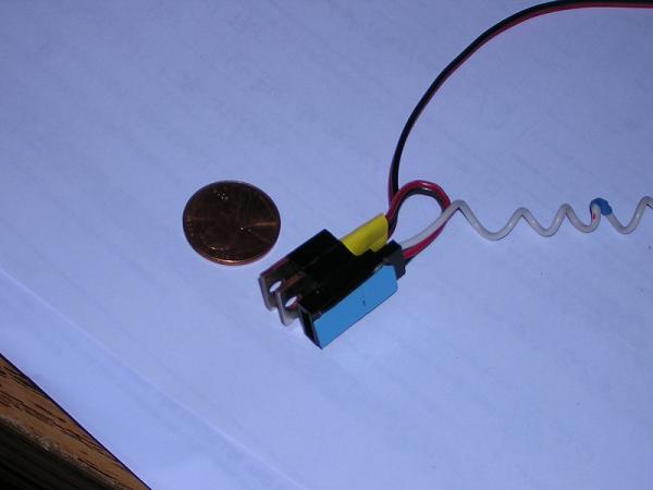

Originally Posted by asw7576
Ok, got it. Yes, that is the finished product !! excelent job Pit Crew :nod: http://www.mircmicro.com/modules/For...smiles/023.gif.
http://www.rctech.net/forum/attachme...hmentid=102181
Thanks.
I used 7805's.
The white wire plugs into the receiver for the signal to the servo. The servo plugs into the plug that is glued to the two 7805's.
It worked really well. But, with the servo I run and the very tight high traction track I run on, the very slight decrease in servo speed was enough to make a very VERY slight difference in response. SO, I still use the device, but use it to power my Personal Transponder. I plugged the cap back into the receiver and run my power for the servo off the receiver.
I am sure the device would work much better with the 7806's, for running the servo..(6volts) I didn't know they made those!! I"m going to try and find some of them and rebuild the device.
Thanks :D
