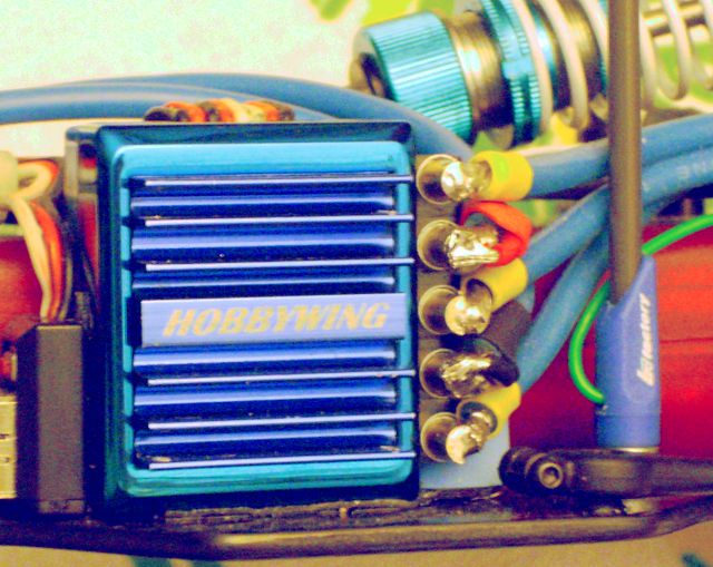

1 Attachment(s)
Originally Posted by COBRARACING (Post 8460048)
Looks good except for one thing the soldering looks shocking especially with the positive and negative wiring
You need to heat the connectors first and melt the solder in the connector the heat the wire and allow the solder to flow on the wire strands then heat the connectors on its side and feed the wire direct in the connector hole .Hold it for 3 seconds and then let go .dont try and put solder and heat and the connector with the wiore at the same time it will not work and look poor.
Yes - that's how it's done. What looks like bad soldering is the cap wires soldered on top of the pos & neg wires.
http://www.rctech.net/forum/attachme...1&d=1294640454
But still no answer about the v3.0_508_No timing software. I suppose it's not in this package ...?
