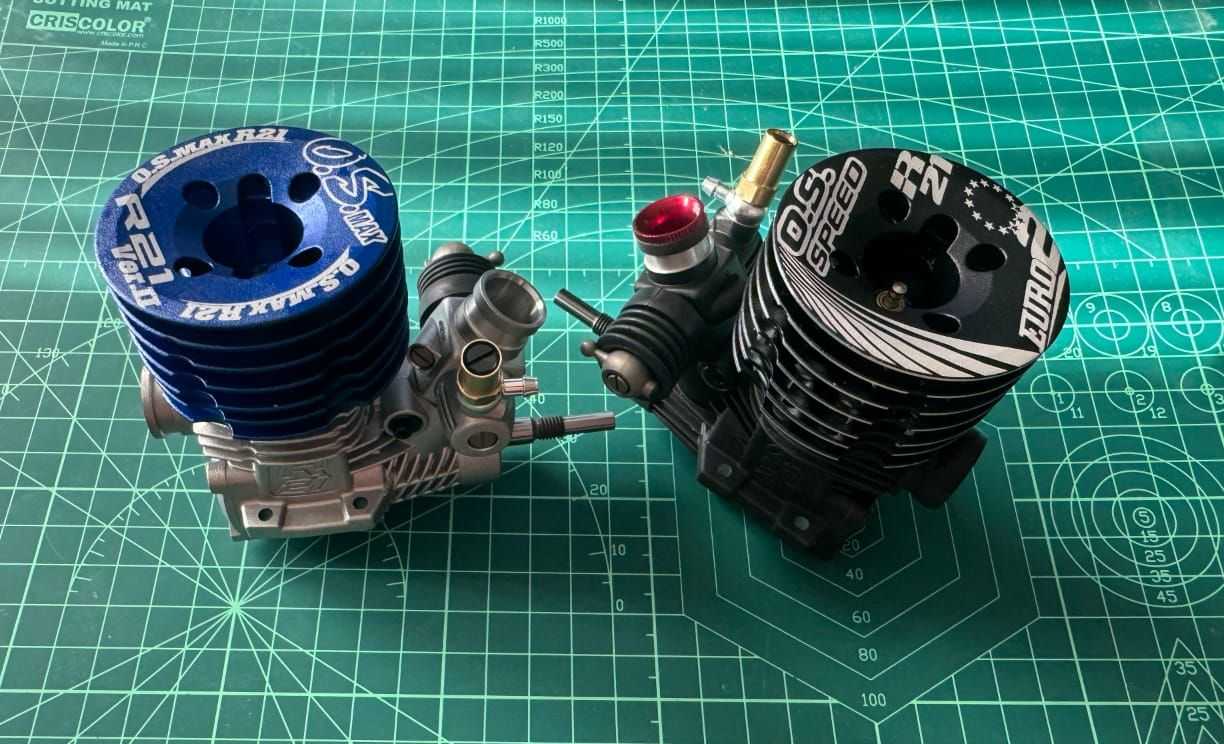

Just received those two beauties (along some other bits) from Chez Rody. Euro 2 is a well known with a lot of info, but the R21 Version II is a complete unknown and almost nothing is out about this mill.
My bet is about being a 5 port sleeve and for what it seems, nothing exotic on it (not needed in reality) but looking forward to break-in and ride it for practice and club running.

The v1 5 port is a decent engine. No true high performance but also not bad as well. The V2 is also on my list to see what it is and make it to a faster one. Timing wise I do not think there are changes.
