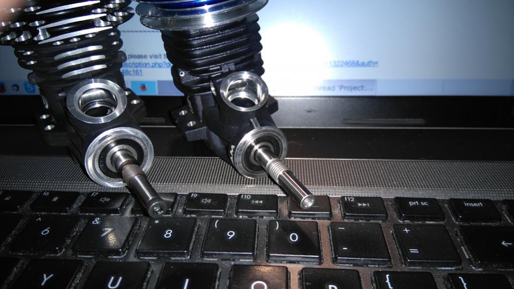

Thank you for answers.
Most maybe has metal shield but I have rubber ones
Project: Break in Dutch machine-silniki.jpg
Now I will try to build my machine and test it on LRP ZZ.12X team spec.2 or XRD .12 hard tuned
Originally Posted by Roelof
The oil I used so far is common 2-stroke oil used with homebrew fuel. I do not expect the rubber rings are affected. The only rubber ring is indeed the one in the carb shaft.
I do not think these silicone rings are affected by any kind of oil but you can always take it out. Most onroad engines have a metal shield in the front bearing. The seal of the front bearing is placed close to the cover and is above oil level, also the large hole where the crankshaft is comming through is giving some cooling.
From the original Dutch Break in guy I haven't heard any issues with the seals and his construction has the front bearing totaly covered in hot oil. I should look up the specs but I expect 90 degrees celcius is pinuts to withstand.
The wires going inside the oil bath are silicone wires from electric racing, the shielding can withstand high temperatures. The shrinkwrap does not melt either. And because it is oil and low voltage powered there is no way to have a shortcut.

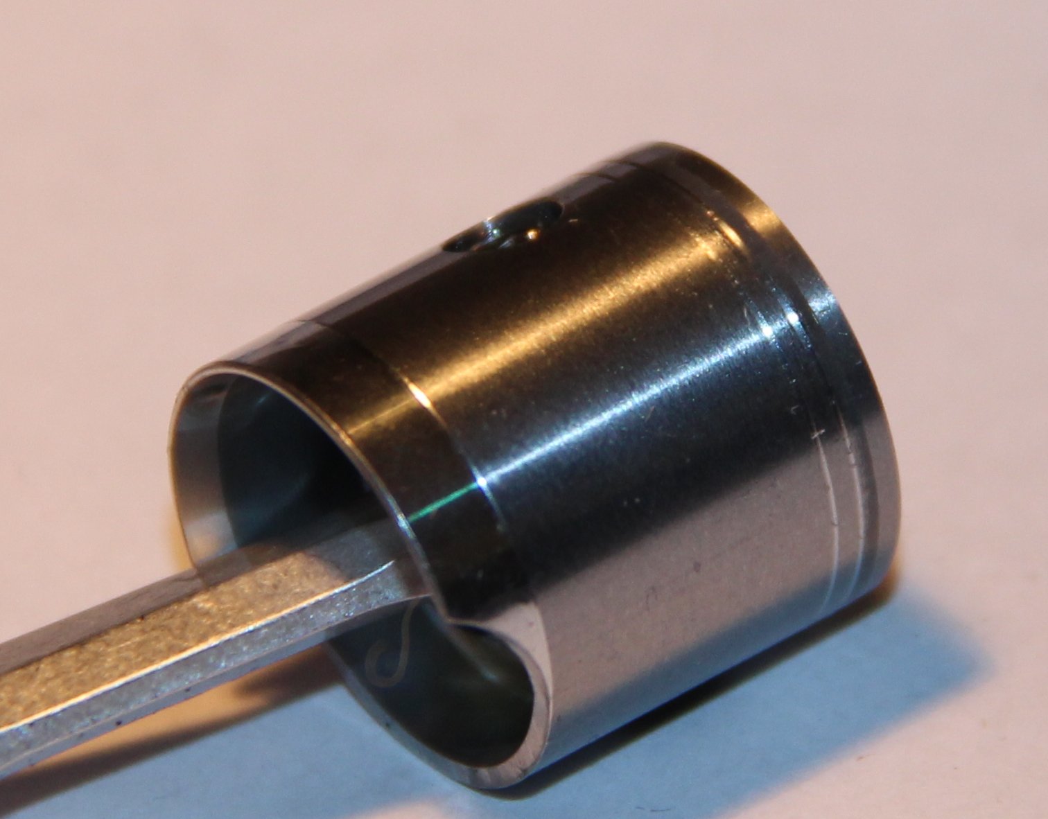

An OS piston after 9 hours. Used oil: Shell 0w20
Wau!! Looking good. How about the oil? Can it be re-used or do you need to have a fresh oil for every single engine? And how much is the consumption, 0,5liters or something?

In my oil there were small metal particles shown, for sure if you filter it it can be re-used. Richard does not have any dirt in his oil and he can reuse his oil w/o filtering it. (Although I think it is OK to do a 2nd engine with my oil w/o filtering). Tonight I will post a photo of the oil.
My setup takes about 380cc of oil.

This is the piston of an Ielasi Tuned 9CL after 9 hours. The touching surface is at the top side of the piston.

[QUOTE=Roelof;14433033]This is the piston of an Ielasi Tuned 9CL after 9 hours. The touching surface is at the top side of the piston.
That does not make it right.
That is an oil scraper.
Piston should be barrel shaped near the top (at operating temp profile) with the sealing surface between the 2 oil grooves.
JTeamtech is offline
